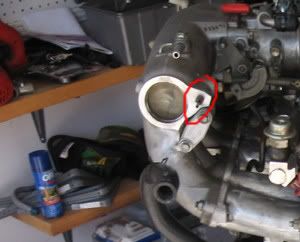

ok everyone im finishing up my swap and i have a few questions
what hooks up to that vaccum? i have searched for hours to find something that would go there but im lost

It goes to a T that leads over to the boost sensor on the driver's side, and I forgot what on the passenger side...
A good tip is to REMOVE that until after the engine is in, as it's very easy to snap off...

^ On the passingerside it goes through a small plastic tube that goes to the heater valve, and like Poodles said those things are very easy to bend and break.

haha thanks guys, i learned the hard way with the na manifold... i kepted the new one nice and good though!!!
