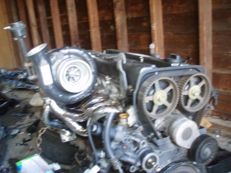

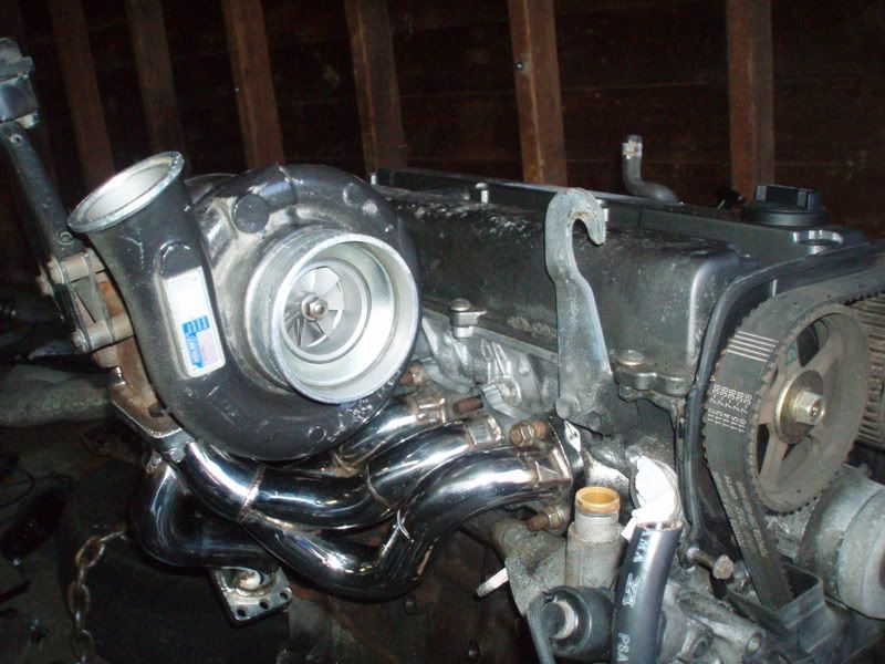

I got my holset hx-35 yesterday and since the turbine housing it has on it now is t3 I figured I might as well bolt it up and see how it looks. Btw it is going to be clocked down, with a different turbine housing so the wastegate isn't going to stick up like that.

where did you get it from and how much if you dont mind me asking?
looks good
that wg is hilarious

You'll want to weld that inner wastegate door closed, and run an external. It will boost creep like mad if you don't.
Ive been there grasshoppa.
Nice setup though, you should make some good numbers...

I got it off ebay for $350. The turbine housing I'm using has a 38mm internal wastegate that they say runs 25lbs+ with no creep. I'm going to be running multi port water injection and I'm hoping to hit 500rwhp at like 20-25lbs on pump.

nice lookin. This is a fun turbo. Raise your rev limit and get some cams? Which turbine housing you goin with? It sounds like the one on the turbo trader? I was looking at that one too seems like a good buy. I know you'll hit your goal that turbo boosts hard~!
