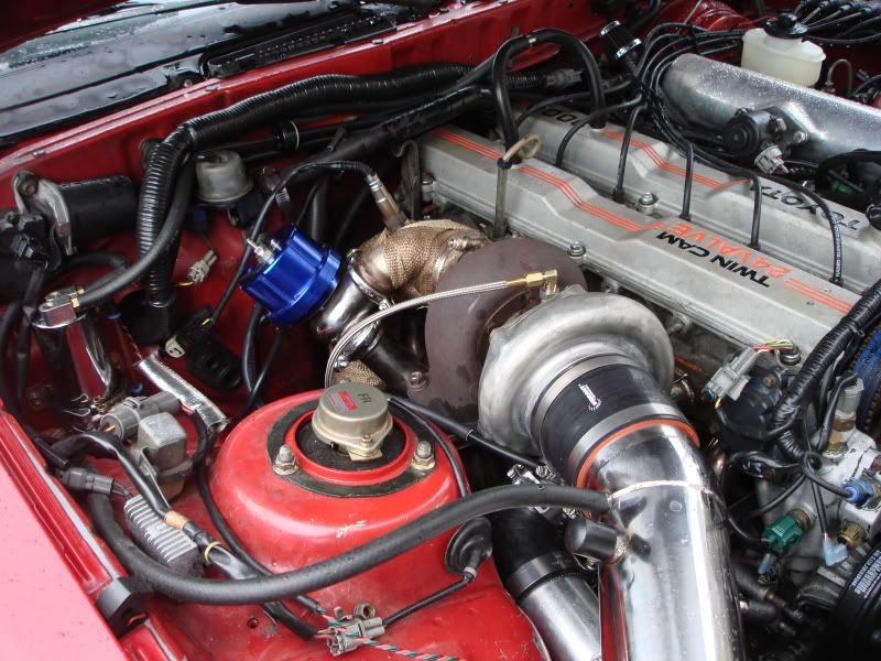

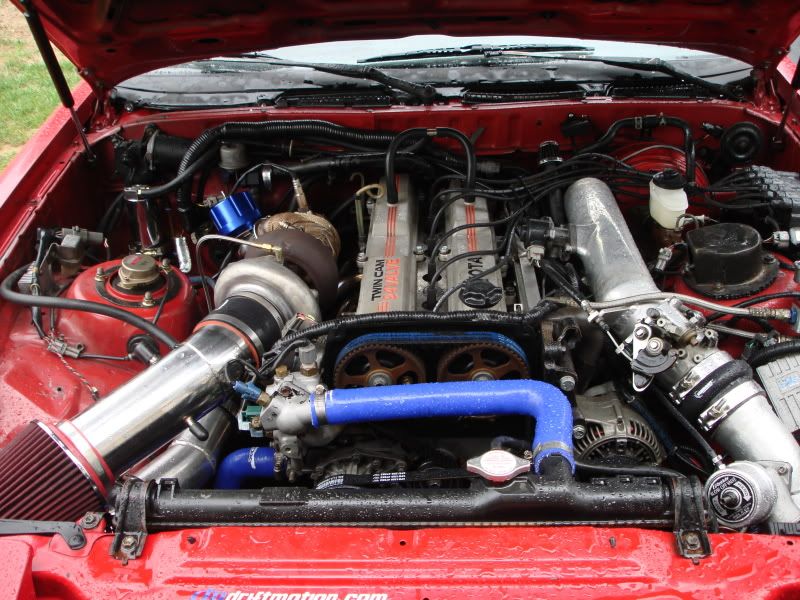

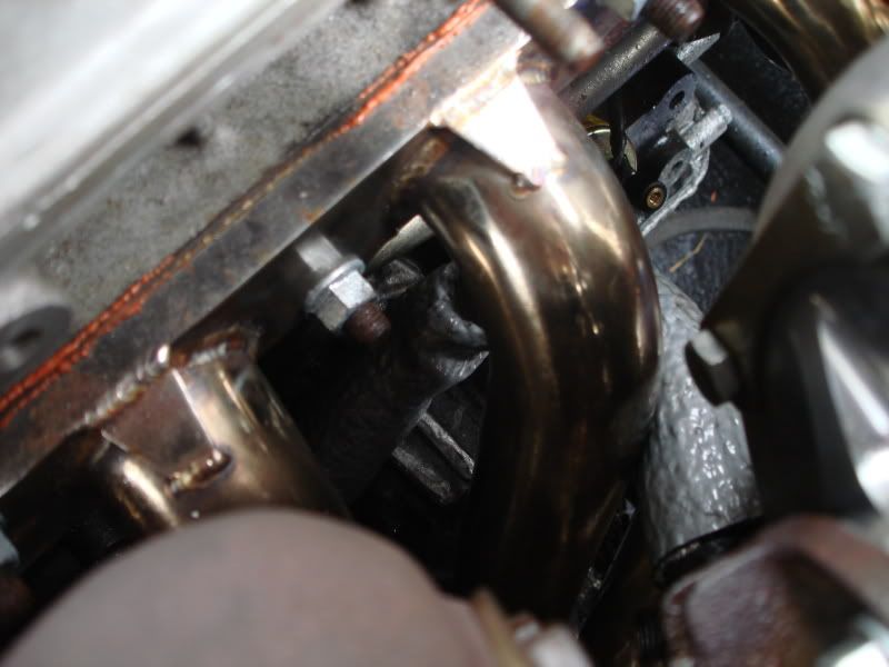

Alrighty, I got the line made but ran into a snag, can't find the proper fitting to return the -3 line into the block. The guy at the hose/fittings shop couldn't id the the thread on my old fitting, the end going into the block. Also I took a few snapshots of my engine quick, please excuse the water under the hood as it's raining like a mofo right now! Oh and after reinstalling the turbo and everything I noticed that when the shop ran a new return line it definitely looks like it could get kinked pretty easy, I have a shot of it but it's pretty dark..Onto the pics...
Oh and sorry if the pics come in a tad big!!:icon_bigg
Edit: Im going to have a new return line made, the one that is on there is junk and is probably half the reason the turbo was leaking oil. If not the main reason.

Nice location for the coil packs :)
I don't see a problem with the catch can setup, is it possible to open it and see how the baffles are done?
The restrictor is a smart idea, how is it you've got such high start up pressure?
The dump line looks adequate for its purpose, though how long it'll live against the header is to be seen :D

Thanks man, the return line is being changed for a -10 line with an fittings. When I pulled everything off I could see the return hose being kinked slightly, as far as start up pressure I'm not sure but when the car warms up my electric oil gauge reads about 60psi, could be off though who knows...

I can't tell from the pictures but make sure the pcv and catch can isn't venting any where to the atmosphere.
Also, dollars to dog nuts the drain line being kinked and or going up hill was your culprit more than the 60psi of oil pressure.
