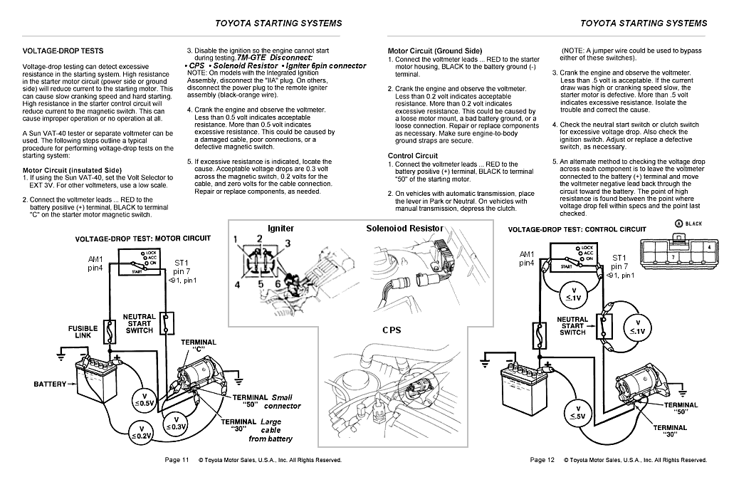

alright, i bought my supra a few months ago, and it started and ran great. Then, a few weeks ago, i went into my car to start it..... i turned the key, all lights on panel = normal, but when i turn to the start position, nothing, all i hear is a click from the antilock brake system area (the right side of the car).....
summary:
if i start the car via the ignition key, the car doesnt start, just hear a click noise.
if i bypass the starter by turning on the ignition switch and attaching a wire from the starter to the positive battery terminal, it starts
anyone have any advice or help?????

Supras dont have a key fob remote if thats what you mean. The factory alarm is just manually set with the key.
Also, that wiring digram is helpfull if checking for a voltage drop, but its a bit misleading because there is so much more to the circuit than that. There is starter relay and a theft deterrent computer not shown there.
Here is the TSRM diagram:
http://www.cygnusx1.net/Supra/Library/TSRM/MK3/manual.aspx?Section=D&Page=3
