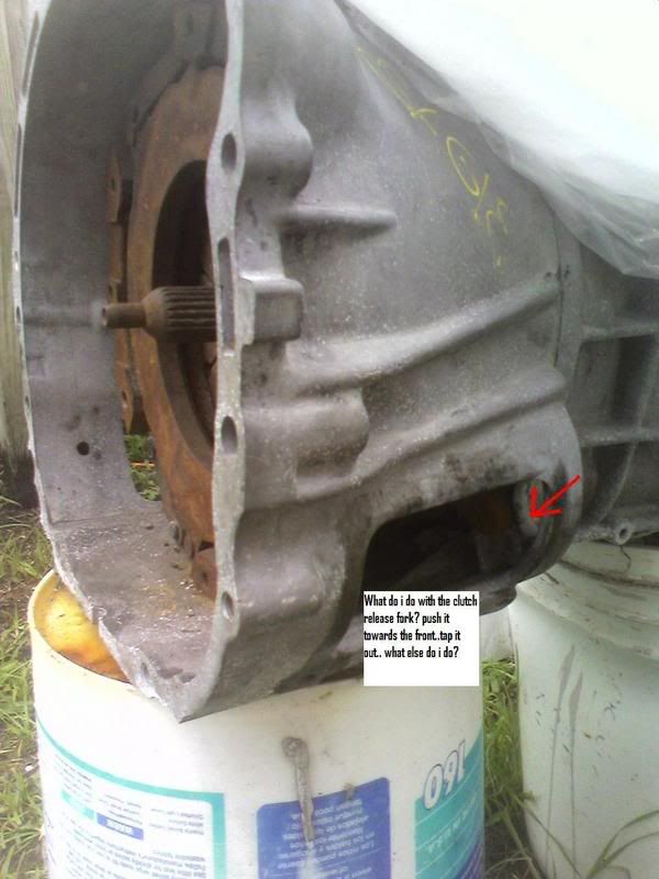

The release fork should be tapped towards the front...the pp slides a bit foward but doesnt come out... just gets stuck..what am i missing??

pull it out through the inspection plate hole
there is a little spring that holds it in, just yank, it will come out...
