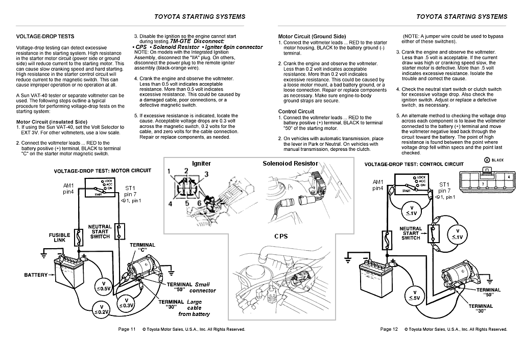

voltage-drop test starter

It has been raining but once it stops I will give this a try. Thanks for the info. Hopefully I can find the prob.
