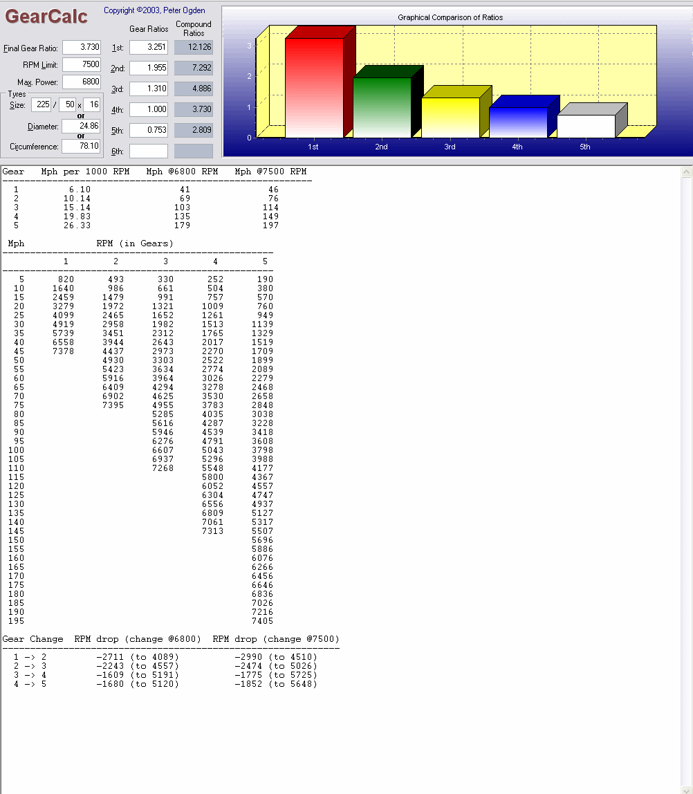

cool little program:
GearCalc said:
GearCalc is a program that calculates theoretical maximum speeds in each gear and speed per 1000 RPM (revolutions per minute), given the maximum RPM of the engine (redline), the gear ratios, tyre size and the differential ratio. It also produces a chart of RPM values for every 10 Km/h increment in metric mode or every 5 MPH increment and gear up to the redline. Finally, it also calculates the rev drop at each gear change.
final gear ratio for lsd is: 3.73
it has built in parameters for R154 and W58
