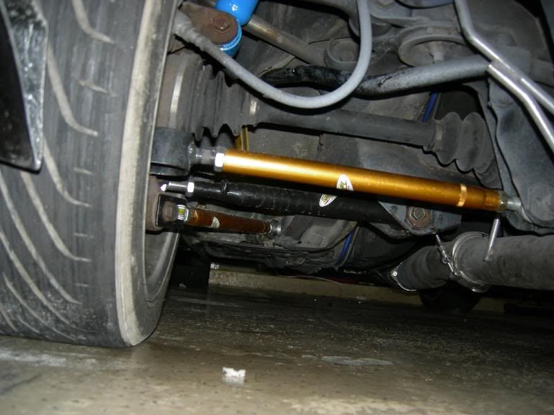

adampecush;1288050 said:
interesting jackstand placement you've got there...
haha, atleast his crease on the body there is still nice straight.
