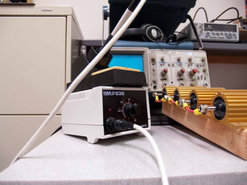

i solder a lot by trade. i have the hakko 936 like someone else, the digital 937 and for field work i have the master ulta.
good quality solder is key also. i usually use kester or multicore 60. be sure you are using the right gauge for the job.
