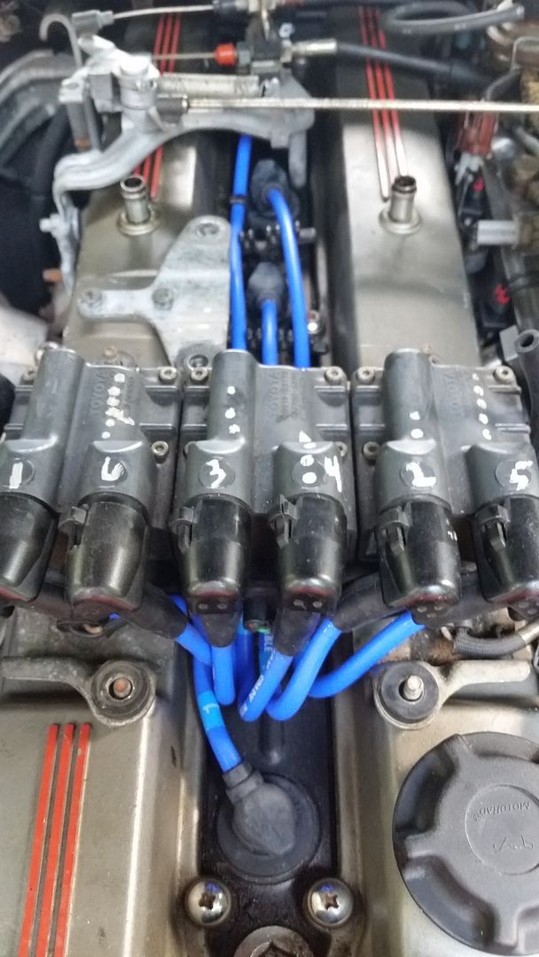

Yes, if the engine was fully warmed up, and I gave wot, occasionally it would cut out on a cylinder.
Now, this WAS what it was doing, and I wasn't sure if it was an injector connection, or a spark plug wire grounding out.
I replaced plugs, cleaned the injector contacts, cleaned the igniter ground, and today I am picking up new NGK wires.
Since I did this work, the engine doesn't drop a cylinder at wot anymore.
However, it will stumble at idle- I.E.- it will drop from 700 rpm, to an occasional sputtering at 500rpm. Again, at full operating temp.
I tested the coils, they are at normal resistance, and I saw no cracks on the exteriors.
I will report back after changing plug wires(they look pretty old)

Update:
Replaced plug wires, no change. :(
All plug wires are in the #3 valve cover wire holders. I will check the cps wires,
to see if there is any effect from messing with them.
