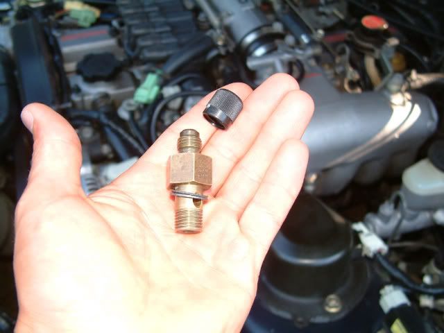

Got mine from Lance Wolken back in the MKIII days.
Replaces the Banjo bolt for the CSI while offering a test port.

I use a miniature stainless steel quick connect on a tapped CSI bolt. My fuel test/injector cleaning gear has the mating coupler. What piratetip has is slick though and the way to go if it can still be had. Has to be a lot cheaper too.
