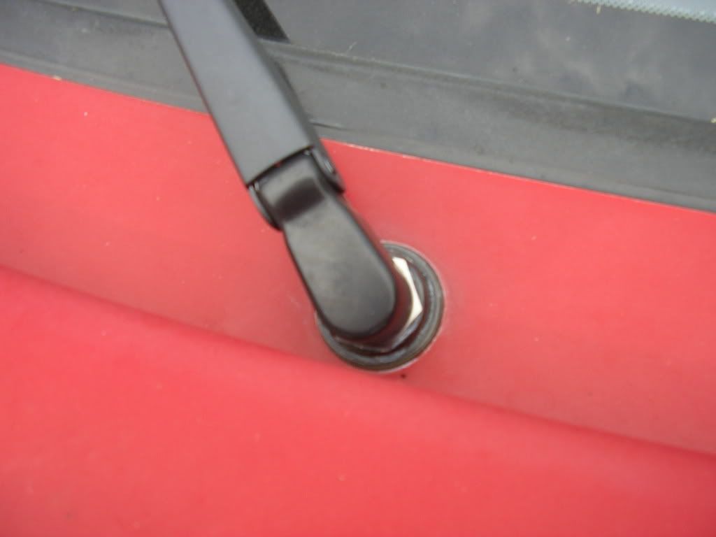

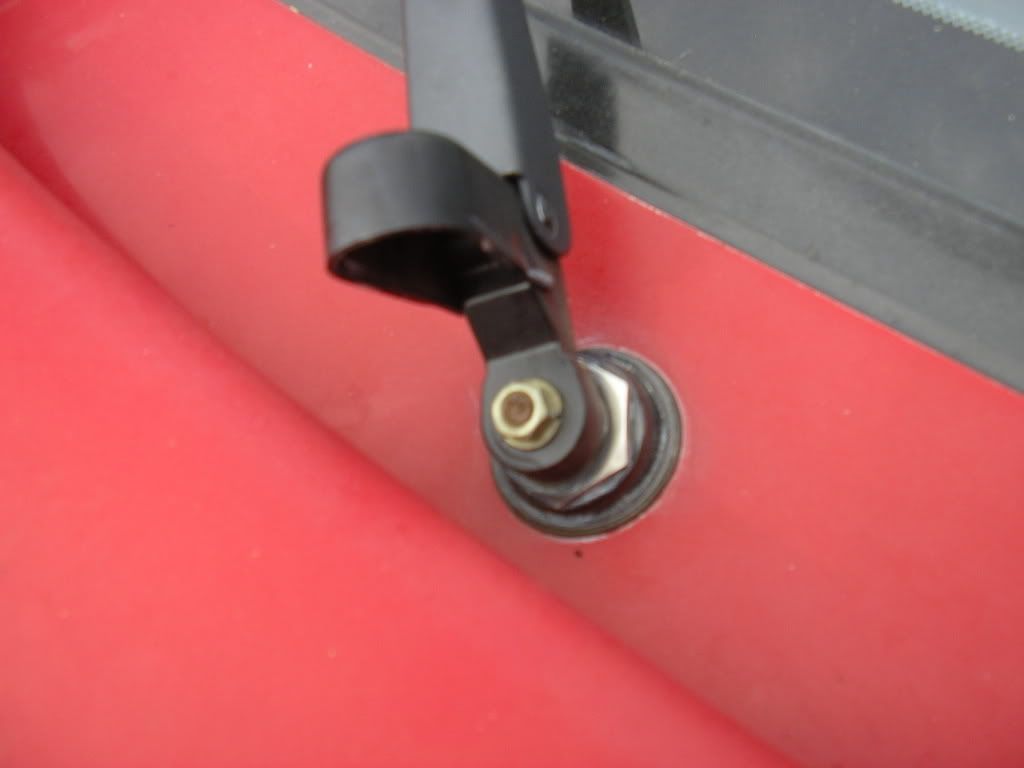

All of the wiper arms are easily removed from the top. Only 1 bolt holds them on at the base. Get away from the glass...
You don't have to remove the interior pieces at all to get the arm off...
(oddly enough I've answered this question before so I have pics!)
Looks hard to remove, doesn't it?
NOPE! Really easy!
Now take it off and work on a workbench where the arm can be held instead of working where you'll break glass and drillbits.

Thank you! I can't believe it was that easy to take off.
