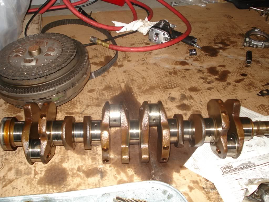

Does this help?

A little bit, that's basically the picture I already have from my crank lol Thanks though :)

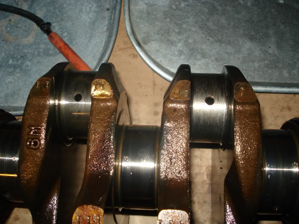

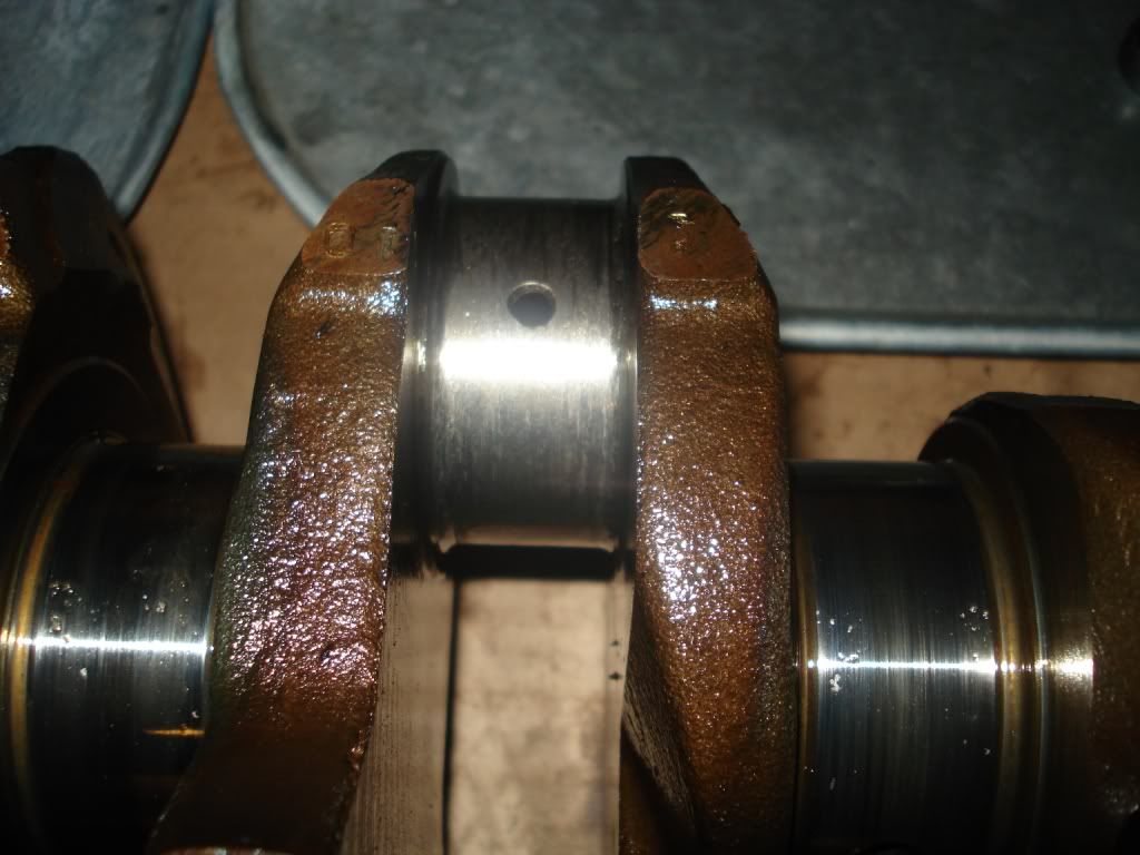

If someone has more of a side profile, so I can see the different shapes of the counterweights, that would be awesome!

Thanks Emilio, that helps show the profile of the weird angular counterweights :)
