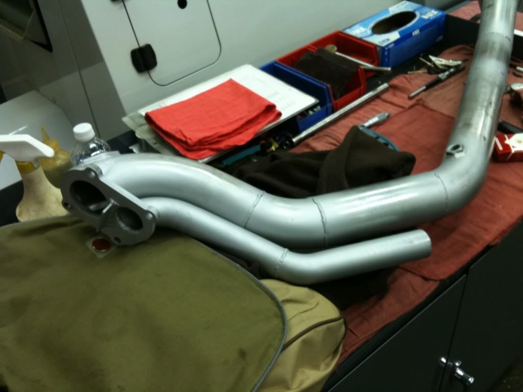

I'm betting that your downpipe is NOT 3" at the flange where it mounts to the elbow since 99% of the downpipes are knock-offs of the HKS one (that and it wouldn't seal with the stock gasket)
i get it now, thanks. now that you mention it, it does look like the bends arent quite right and it seems like a custom job but i dont know what brand it is except for a flowmaster high flow cat and the apex n1..its got the worst looking weld job for a hangar...destroyed a perfect finish on that pipe

Raptor Racing's DDP is rerouted and comes with a flex section, and I believe BIC's can be ordered as such as well.
The chinese ones come that way as well, but their quality is hit or miss now (seem like they stopped adding the actually divider flange, which kills the point of the DDP)
