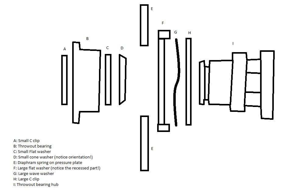

In that case, mine were probably improperly installed before I ended up replacing the clutch. the snap rings were a bit bent, and the wave washer allowed too much play.
#1 reason the hub fails is improper installation. Very few of these cars will be on their original clutches, so it's safe to assume it's installed incorrectly.
Correct installation: (my terrible MS Paint drawing, but it's more clear than the TSRM unless you have a paper version)
