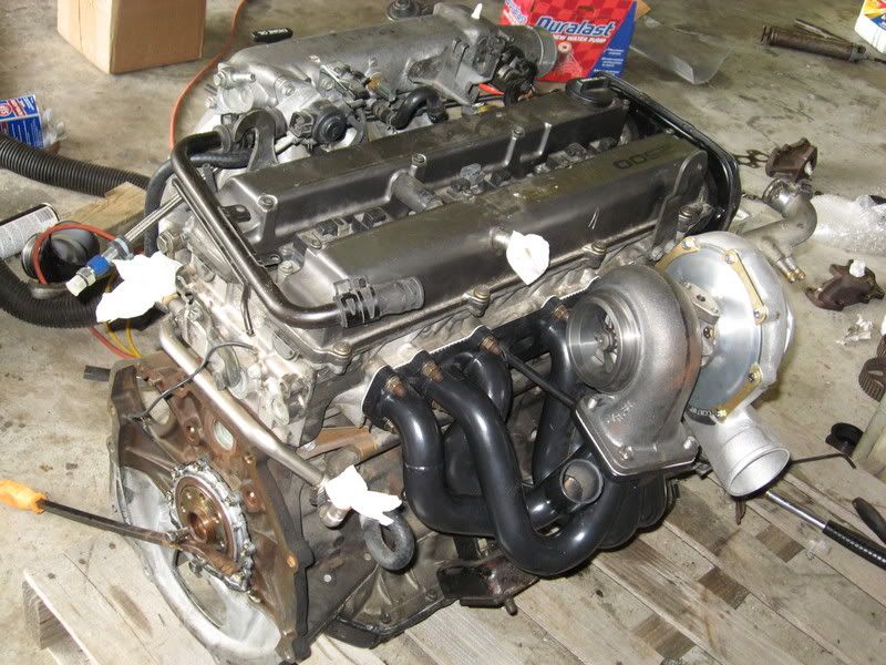

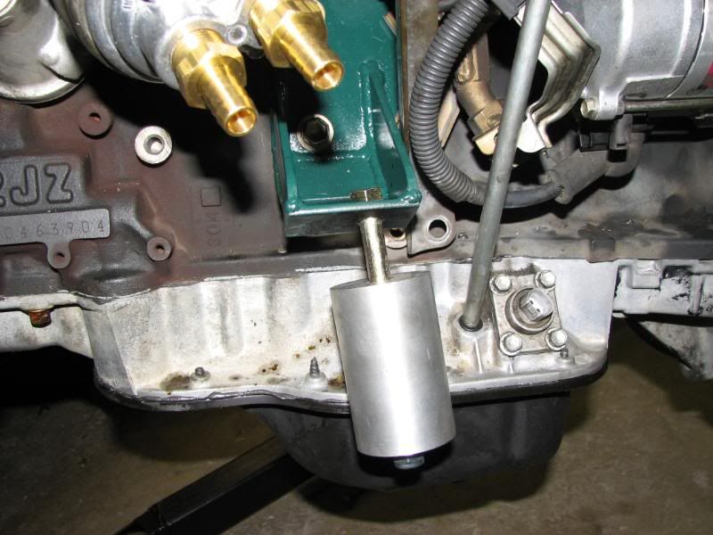

anyone have pictures of the pan for the soarer? i have a few of the 1jz in my uild thread
86_sports_1jz
slow 700hp build...
Aug 27, 2006
1,217
OK
spipedong;919485 said:
I'm pretty sure my soarer engine was mid/front sump and I had to swap the JZA70 pan to it.
since your motor was a front sump you didn't have a soarer motor, you had a chaser motor. soarers are mid/rear sumps and you don't need to change the oil pan if dropping into a supra
here are some i have, they aren't great though it will just give you an idea of where the sump is
tlo86
Ninja Editor 'Since 05'
Jul 24, 2005
3,914
Colorado
have a better pic of the pan? ;) it kind of looks like it is more mid than anything but of course im not a pro just curious :D
thats the 1jz supras and it sits pretty far back
spipedong
Level 2 Rythym Rogue
Apr 2, 2005
404
Eugene, OR
ohhhh thats what it was. Thanks for the clarification. It must have been a chaser.
