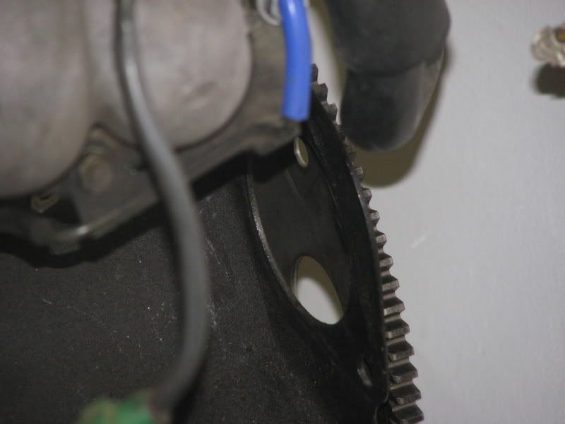

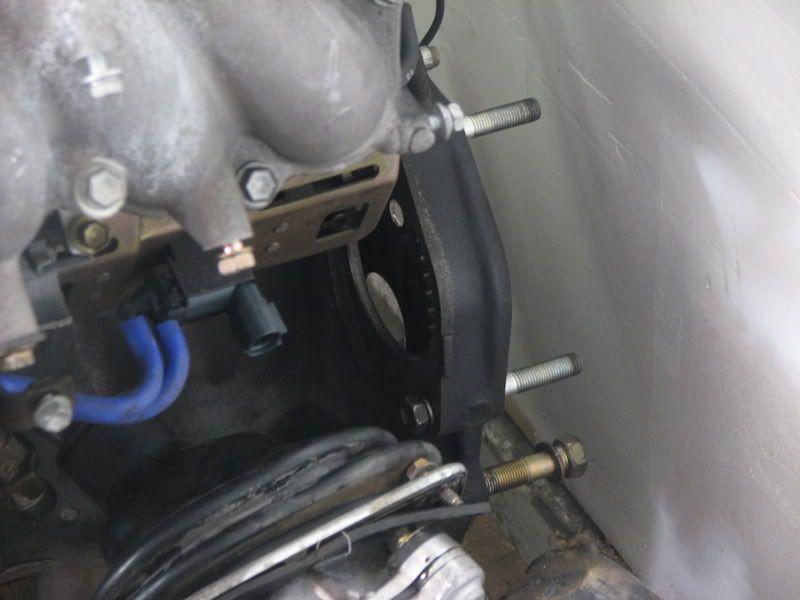

I'm trying to buy a R154 with a 1J bell housing off of craigslist, somewhat locally. From the pics it looks like that is what it is. Can someone confirm this? Just wanted to get a second opinion before I drive a few hundred miles to pick it up. Thanks in advance

they're very close to each other.. hard to tell even in person let alone pics..
only think i see that say it MIGHT be is the 8 bolts on the flywheel

Yeah that is definately a puls, the bell housing looks like it is correct to to me as well (starter location, general shape, etc). Gotta love Toyota for not marking their transmissions.

only way i could tell is the length between the bottom starter bolt and the bellhousing bolt.. iirc the 1jz is shorter then the 7ms.. dont remember teh distances. I can check when i get hom though

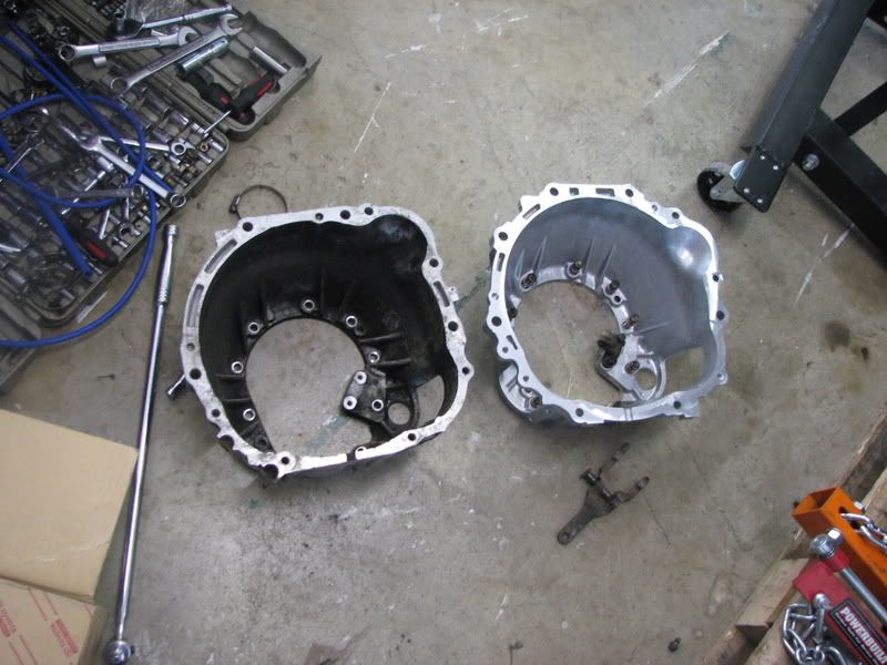

Courtesy of Tlo86. The 1J bellhousing is on the right.
