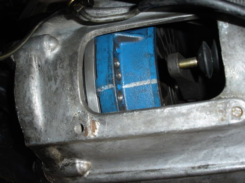

Does someone or can somene take a pic of there tranny for me. I want a pic of underneath the plate where the slave cylinder go to....where you insert the clutch fork. Thanks in advance.

this what you mean?
borrowed from RTA Supras forsale thread..

a trick i learned from doing 2/3 of these is when putting the clutch fork on, assemble the pin, and put the c-clip on, have the clutch cover and disk seperate from flywheel, move the clutch cover towards the tranny, once the clutch hub is at a close spot yoiu can insert the fork, note the position it needs ot be in of course.. and if you do it right you will feel spring tension, then give when it falls into the hook, and then you wont be able to pull it back out.
make sure the hex hub is line up so the fork doesn't jam.
then of course bolt the CC back onto the flywheel in the correct star pattern

Thanks, i'm not sure what i'm doing wrong. I can put the clutch fork in and make it "click" into place but then it is to far forward(close) to the slave cylinder not allowing me to install the slave.
