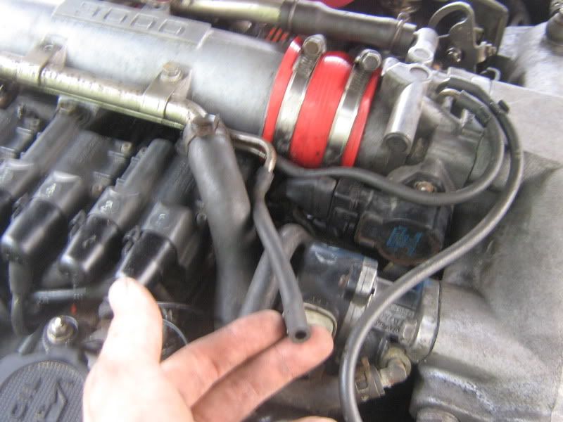

The line coming off of the hard pipe. On the other side of the hard pipe its connected to the bov. Heres a pic. This is the last thing that needs hooked up before I start it. I have looked at every vac diagram and nothing.

Look under the intake manifold, and you'll see the port it hooks up to.
It's the port (in the pic) that has nothing going to it on the 25706 pipe.

'Should be a metal pipe directly below that, which it attaches to. Make sure that the other end of that pipe is connected to the vac tree under the manifold as well.
