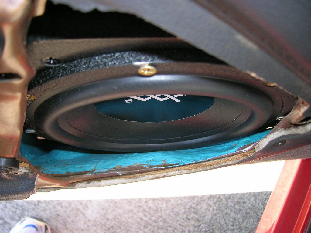

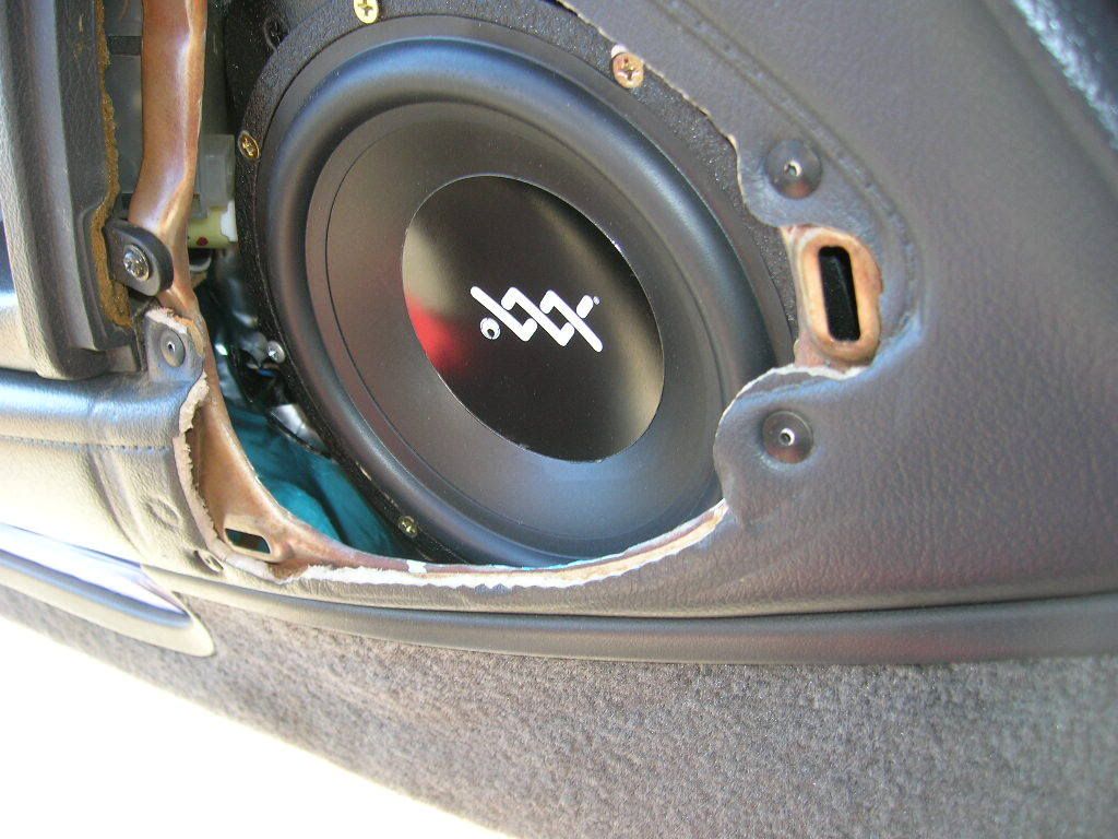

Midrange speakers and tweeters are very directional, so for this project I wanted to get the best stereo imaging possible, without cumbersome kick pods at my feet. This means to have the speakers as far forward as possible, and facing my ears as much as possible with minimal interference. The gear is 5 1/4" MB Quart QM130 midrange speakers and A/D/S PX soft dome tweeters with an A/D/S crossover. These components have won many sound quality competitions in their day.
I chose to pick up a set of 91-92 door panels with the much larger speaker grill opening. I cut out 1/4" MDF wood rings to mount the speakers to, then hot glued 1/4" dowel rod to set the angle of the ring. I then hot glued grill cloth to create the shape for the fiberglass which I then laid, with 2-3 layers.
On the driver's side, I trimmed the grill, wood ring and the speaker basket to have the speaker sit as far out as possible, with maximum angle facing the driver's seat. I used some foam to fill the gap that this caused. The passenger side needed much less angle, and faces the driver seat more easily. I had to bend and trim some of the metal of the door, but nothing major.
The key with an install like this, is to have the speaker airtight to the door panel, so the door itself becomes the enclosure. I have the same door speakers in my MK2, and they sound phenomenal if you put your head in the center of the car, but the stereo imaging gets lost when sitting normally. I will mount the A/D/S tweeters on the kick panels, which should nicely polish off the stereo soundstage! I will let you know how it sounds when its done!
Driver's side:
Passenger side:
I almost had a clearance issue with the window, but got away with it!

Looks good, but how can you insure that the speaker gest sealed to the actual door? And have fun sealing the doors them selves, i sure strugled with it and still know that there are leaks, plus we have the problem of too large an enclosure for the 6.5" mids... You certainly were witty and inovative, but i still think there are flaws.
By no means am i trying to put your work down, it looks great and will definitely sound much better than if you were to simply drop the same speakers in the stock mounts. But i feel these supras have much more room for improvement... Especially in creating a smaller enclosure for the mid.
Perhaps for the tweeter you could place them just in front and under the mid. Like on the carpeted part of the door panel? Or there is always the option to place them in pods on the pillars if you dont have a gauge cluster on the drivers side...

Pbasil1, I think that your install is perfect from the technical execution point of view. The level of your skill is very high as well as understanding of source of good sound. Nevertheless, and by no means i want to sound sharp, the original install of this thread has clear engineering advantages. Not on a technical level, but rather on proper design. Heres why.
No, you can not ensure that the speaker will get sealed to the door in free air install. The concepts of "free air" and "sealed" are contradictory. However, his install is more air-tight compared to your type. First of all, as far as i know you have ensured that the thin metal part of the door you mounted the speakers to is completely sealed by anti vibration material. this prevents sound waves from the back of the speaker not to cancel the ones that come from the front of the cone. car audio 101. well done. Then you have put some of that blue stuff behind the speaker ( sound deadening?) to absorb the energy. There is also a huge hole in the door for the window to come up and down. And its right on top of the back of your speaker. Since there is no foam or some sort of soft material to absorb and cancel the sound waves its safe to assume that they bounce off the blue stuff get mixed with road noise thru exterior panel vibration and exit thru the the window opening. Also, you have all that space between the speaker cone and the panel. your speaker is too large and some of its surface is firing into the panels pocket. When you put on the grille and restrict the air movement i think it goes right into that space between the plastic and metal part of the door. Maybe creating turbulence of some kind?
His install is devoid of these problems.
1. The space between the panel and the 1st layer of metal can be completely sealed by blocking heater duct, putting weather striping around the edges of the door and so on. There is no hole on top on the panel and first layer of metal, like between the first layer of metal and second.If the speaker is shallow enough you can also block the stock speaker opening to prevent it from leaking into the space between the metal parts. I don't think thats the case with his install though.
2. he doesn't have all that space between the cone and panel. If you make it pretty enough you don't even need the grille.
Finally I'm not saying that his system will sound better than yours or mine, maybe no one will ever notice the difference at all. But from the design point of view i think he presented the best thing in speaker placement in supra car audio section on this forum. No its not done 100% perfect, but its very creative. And i think we are taking about the perfect design here instead of competing whose system sounds better.

Yes, perhaps the perfect install would be airtight enclosed fiberglass pods to the spec of the door speaker. But in my experience, mids that are airtight to the panel itself and use the door volume to resonate within, produce a nice full sound. I will be crossing my mids over steeply so nothing below 160hz will pass through them anyhow.
Good looking 6.5's! See if you can find some dense foam to seal up the gaps between it and the door panel. Do it to one speaker first, then use your balance controll to listen to it compared to the other one as it is. You might be quite surprised how much better it is :)

Oh by no means am i taking this as an insult or start of an argument. I simply didnt see how the rear of the speaker was going to be sealed in the door. But now you clarified. Perhaps i spoke too soon and should have analyzed the install a bit better.
You are correct in the statement that my mids are too big for the door. I wanted to make a statement with my install. Never have i EVER seen such a large 6.5" mid in my life. And quite frankly they dont get much bigger! Technically these are measured as 6.75" mids, but can be used in custom 7" applications. The basket its self didnt even come close to fitting in the factory speaker pod. Thus, i had to fab a new bracked out of 2 layers of 3/4" mdf, and an extra 1/2" mdf spacer just to enable the window to still roll down.
I have seen on other cars the utilization of the carpeted pocket part of the door, and some day after my car is rebuilt and i get back to the stereo i plan to build a fiberglass enclosure for the door and these same mids to really get it all right.
I appreciate your un biased statements. Its great to have someone who is actually knowledgeable comment on my install, even though some of it may be negative. Im very used to dealing with a cheap kid who thinks that a good system has to have 2 15" subs and 4 tweeters just to sound good....

you must have cut alot of the door away away i was thinking done this befor as in clock the speaker towords me but i shyed away from cutting the door caus ei did not wana risk cuting nice hole and my speakers not hit or tucheing the windows
but you have shown there lots of room to play wiht how much dooor did you cut

Most of the clearance I needed was done with a hammer :) But a small amount of cutting with tin snips was done as well. Not much trouble at all, maybe 15 minutes of work.
