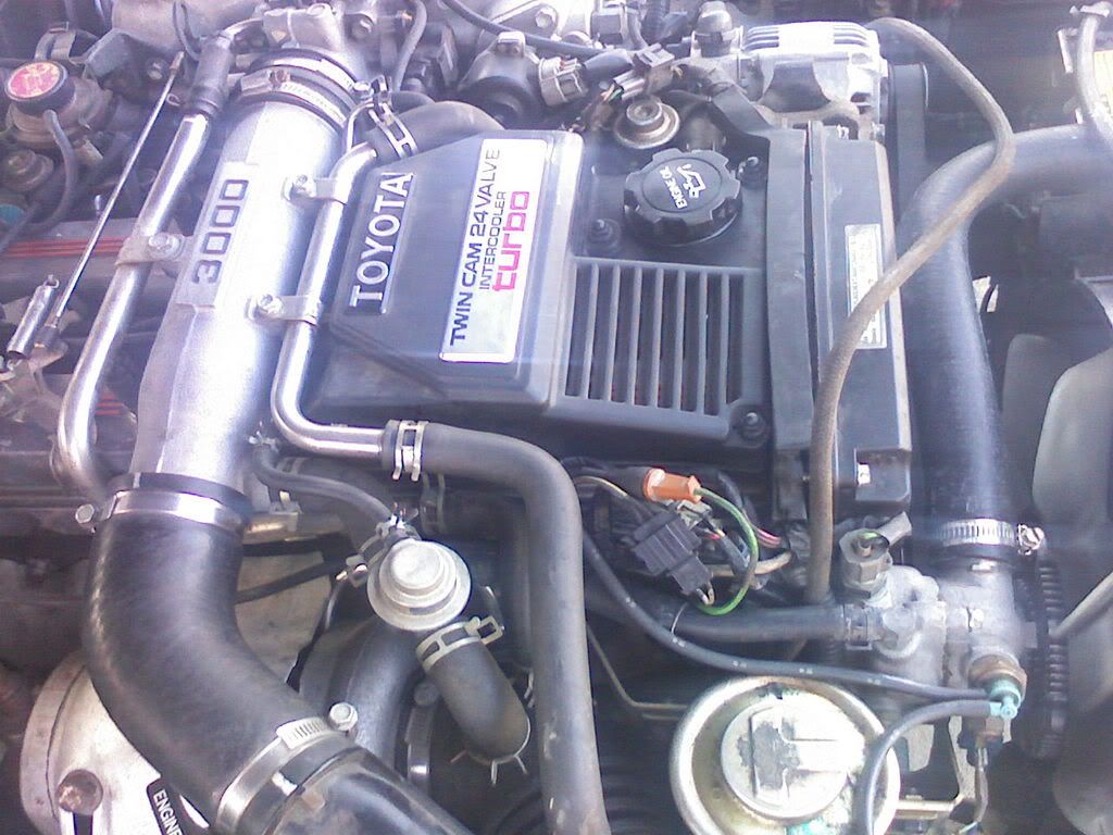

Hey, searched but couldn't really find what I'm looking for. Just got the car back from BHG repair, now the vacuum line for the progressive power steering is draped over the block, the mechanic couldn't figure out where it went. I'm assuming it goes UNDER the block in the wiring harness or something.
Here's what it looks like now:
Does anyone have any pictures/detailed descrpitions of where this is routed? I'd like something really detailed to give him so he can put it back right. Esp if you could post a similar pic to the 2nd one, showing where it goes from the intake mani. Thanks so much!!

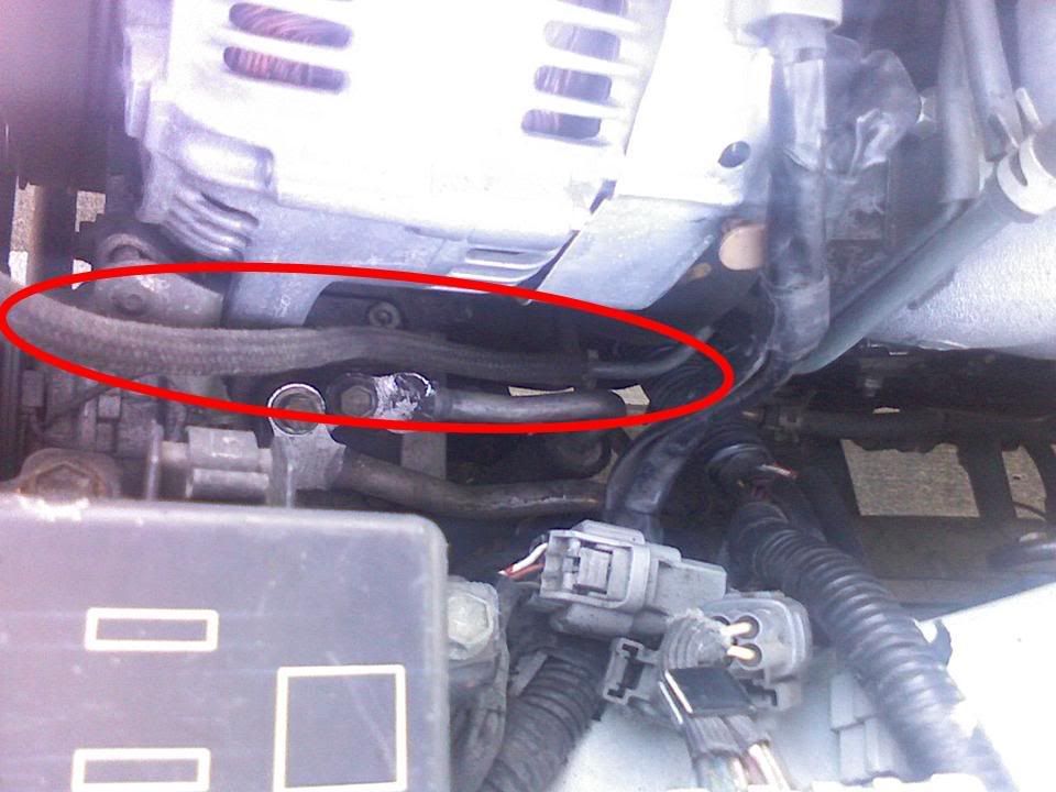

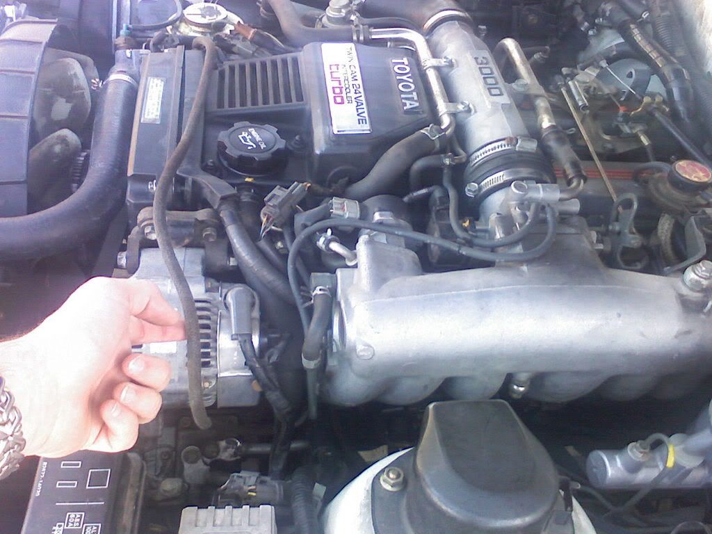

Wait, the hose can't be supposed to be cut and attached, it was always in one piece before! I don't think I follow. Anyway, here's a pic of where the hose heads down to, and a pic of it starting @ the intake mani. Could someone just circle where the hose should go, I got it wide enough you can see the rest of the block. Thanks.
Hose Termination:
Hose Start @ Intake Mani:

I don't there is a vacuum hose for pps...the hose you are talking about is the p/s idle up line. Follow the hose that comes off of the bottom of the accordian hose...it goes to a valve, and then a hose comes from that, to a hardline that runs in front of the timing cover, over to the intake manifold.

Thanks guys! I looked at that forever, I think I was too tired to catch that it was the same line. Grrrrr......feeling retarded here. I'll show that to him, that should be it. I just don't get why there is sooo much hose, though, if its going such a short distance.....w/e...does anyone else thing he might have connected the wrong hose there? IDK.......
