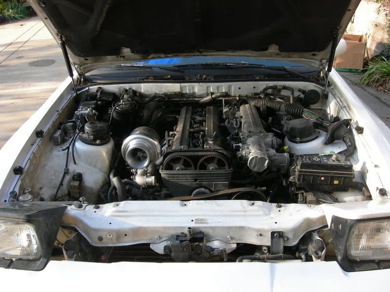

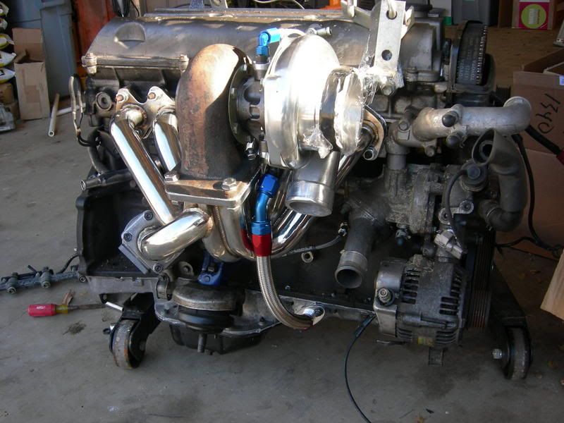

This is my project that I have been working on since the beginning of August. It's taken me a little longer than I had planned, but I'm reaching the end of the under the hood portion and hope to have it driving soon.
Mod list by completion:

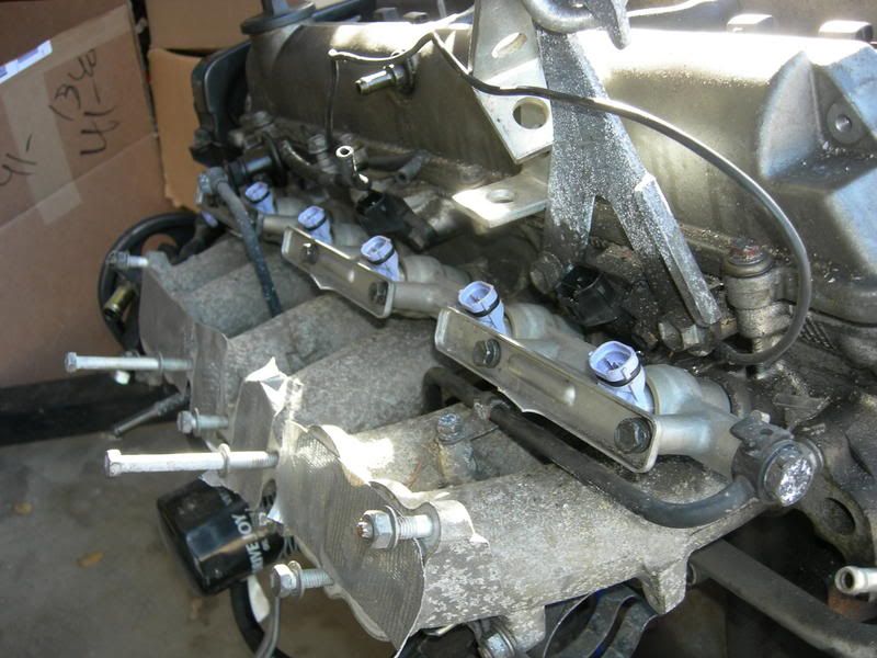

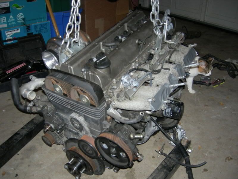

-Aristo 2JZ-GTE with MAP ECU and 7M oil pressure sender to retain factory oil guage functionality
-MKIV 550cc injectors
-Custom wired MKIII resisitor pack for low impedence MKIV injectors
-Walbro fuel pump

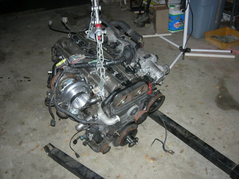

-T67 turbocharger with .84 A/R hotside
-Ebay SS T4 manifold
-50mm HKS replica wastegate (11psi spring)
-Full 3" v-band downpipe => greddy sport exhaust (all I know is it sounded amazing on a 1.5JZ)
-Upgraded 1JZ intercooler setup with full hardpipes
-Super Sequential BOV

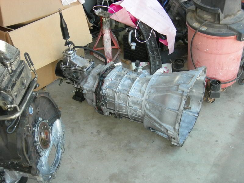

-Manual conversion to an R154 transmission, stock driveshaft for now
-AEM guage type boost controller and wideband o2
-APEX'i SAFC-II
-Intrax lowering springs (Tokico TEMS compatible shocks to come)
Visual mods to come:
-Greddy style front bumper (retaining factor foglights)
-JDM power folding mirrors (maybe)
-Fresh pearl white paint with color matched moldings
-Clear or smoked turn signals (can't decide!)
-5zigen FN0R1-C Bronze Wheels

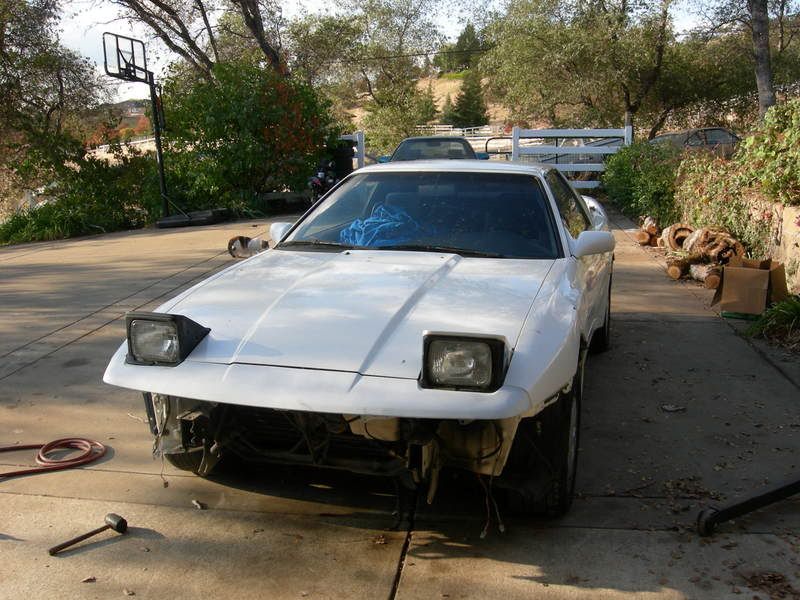

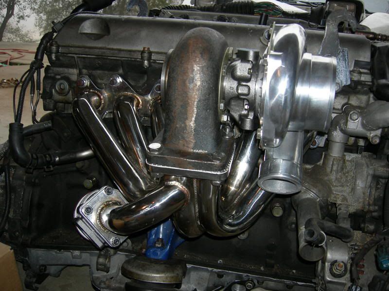

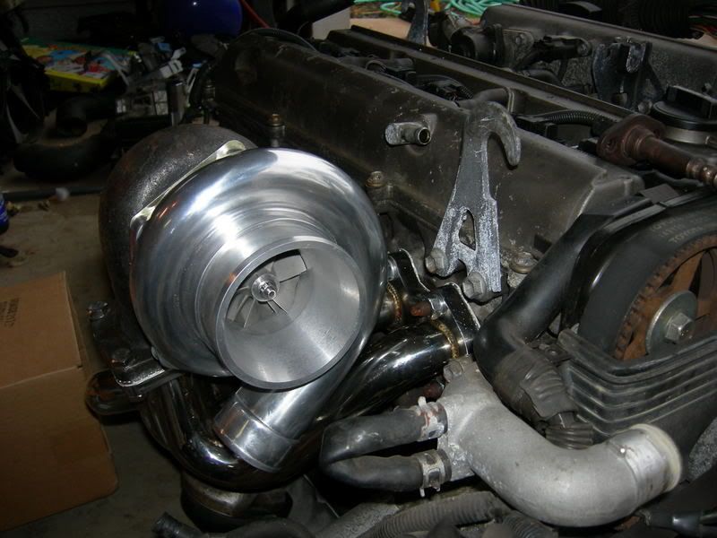

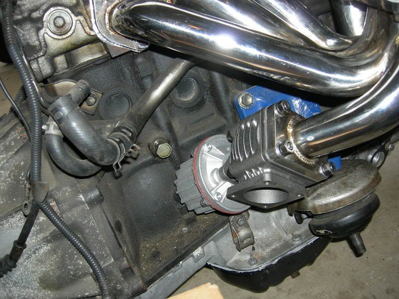

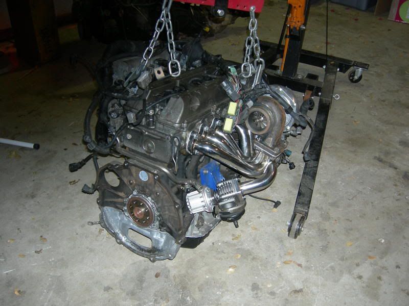

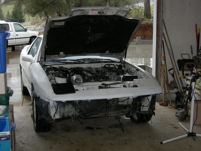

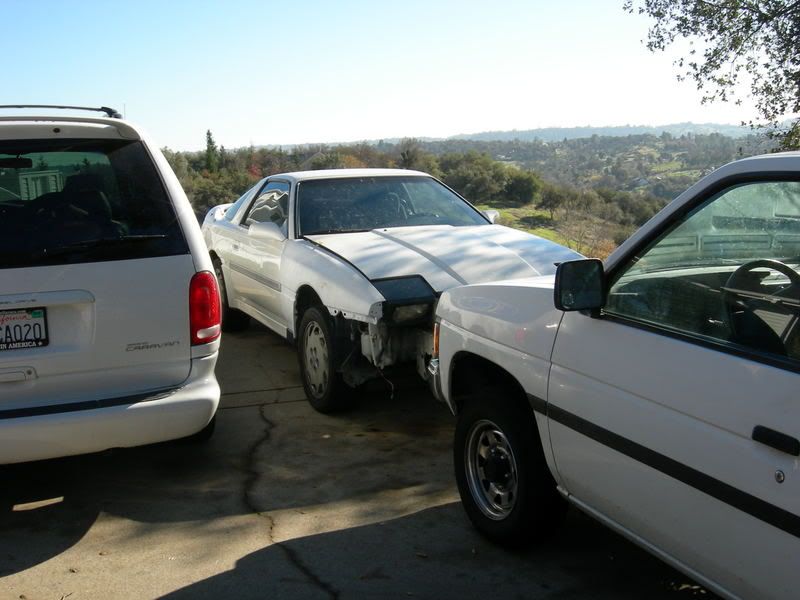

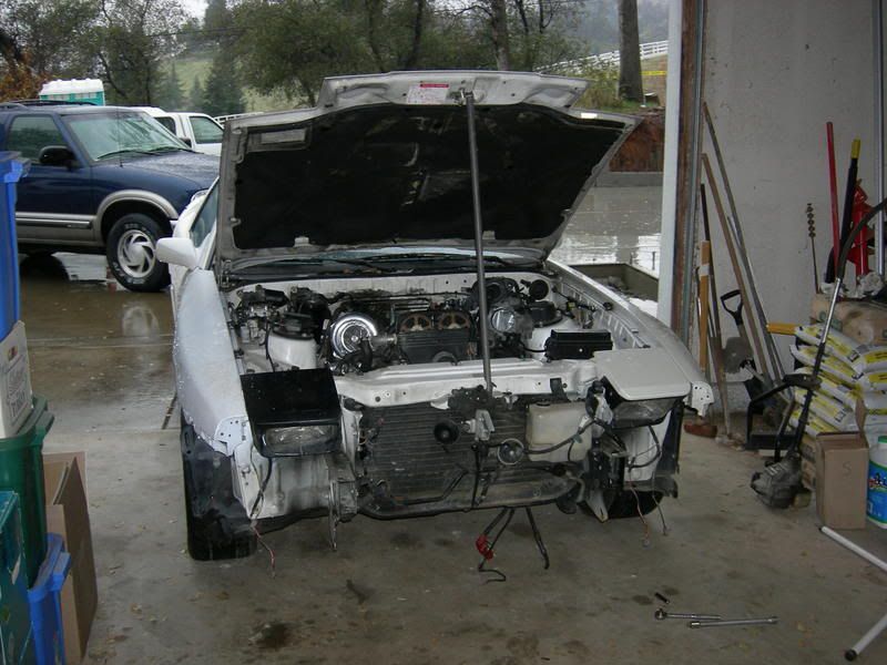

Anyways, here's a few pics of the car as it sits.

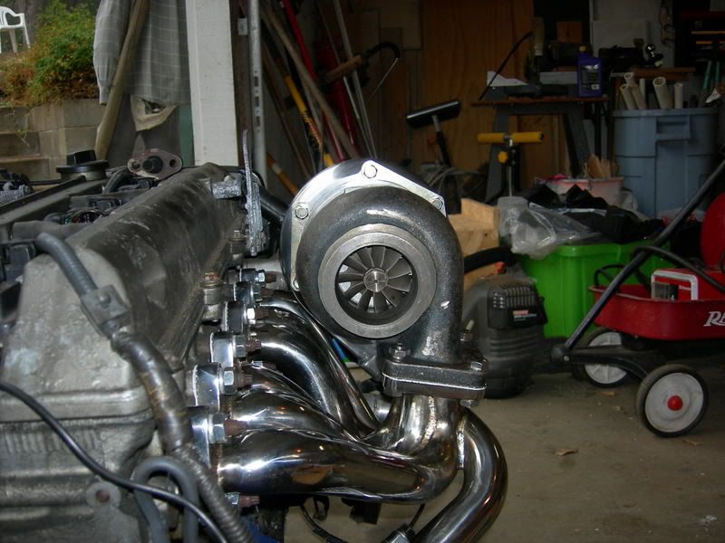

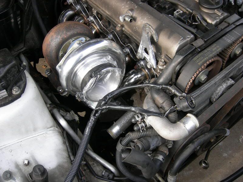

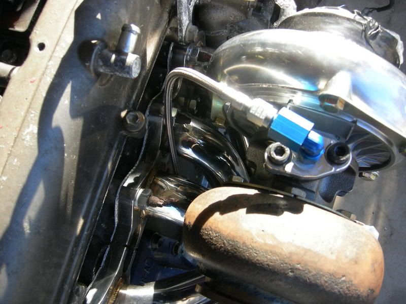

A few pics of my lovely little turbo.

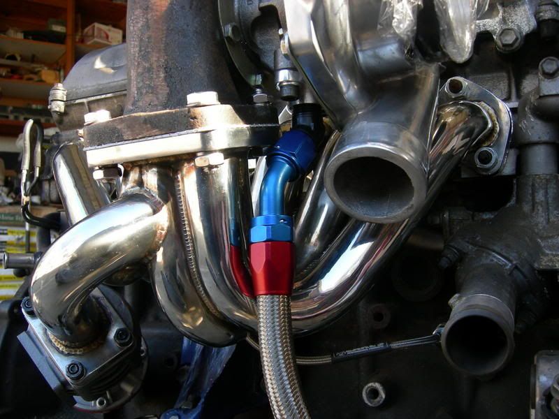

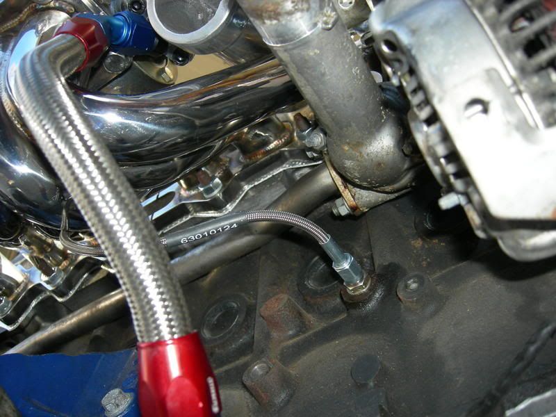

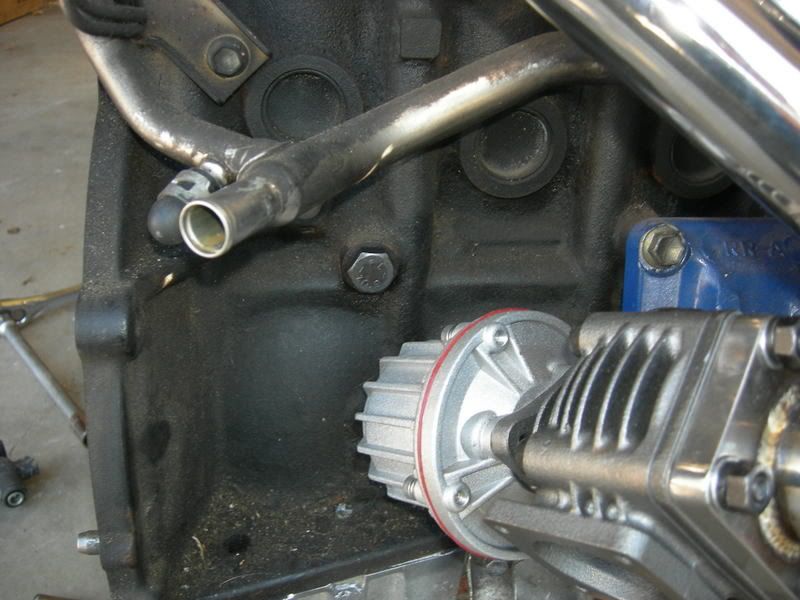

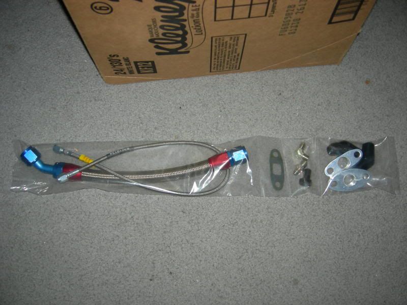

And my BL oil line kit which I have yet to install...
