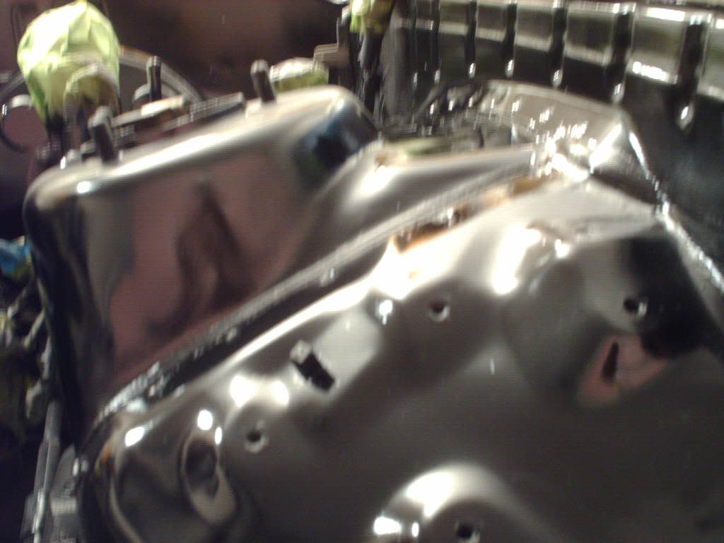

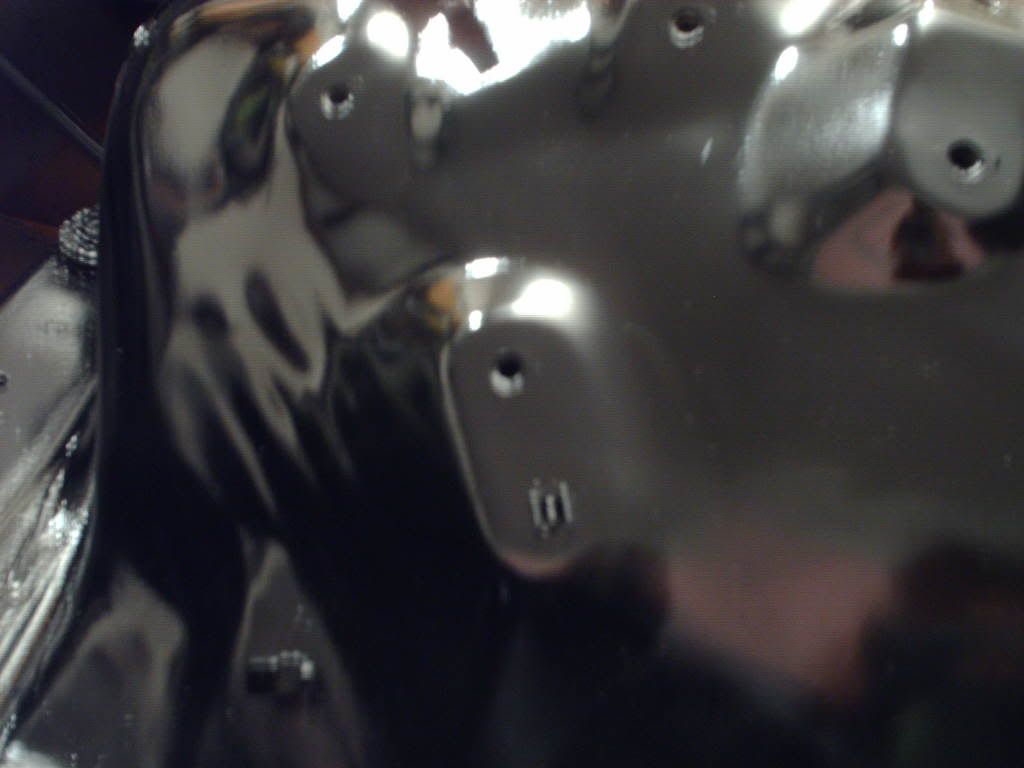

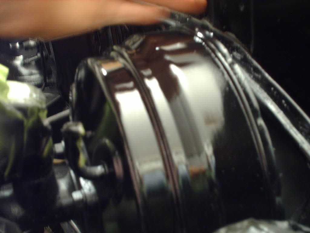

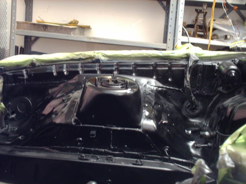

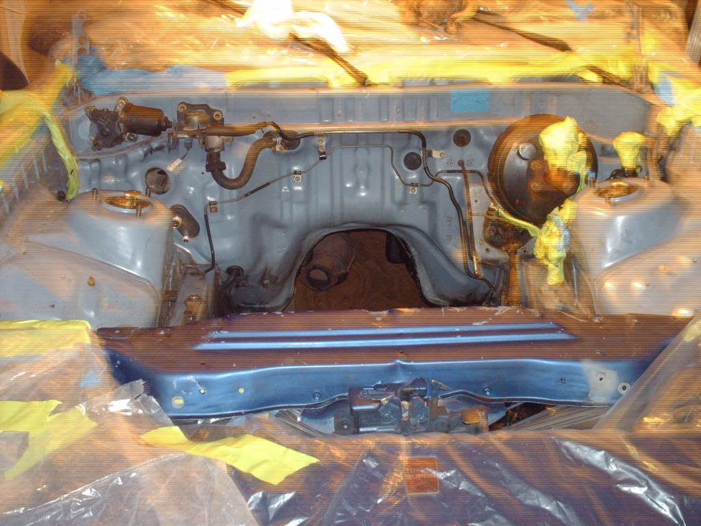

Engine bay before:
Engine bay after:

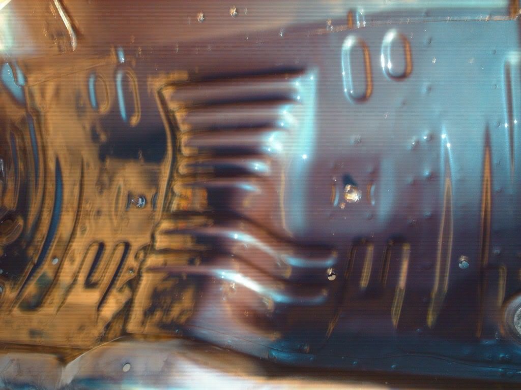

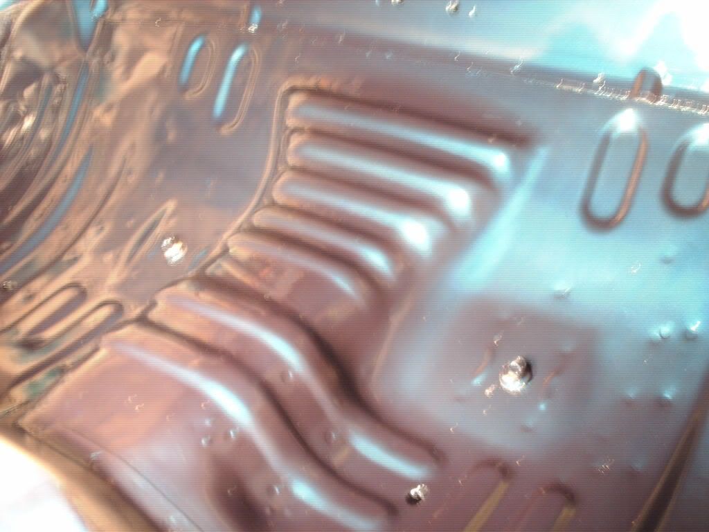

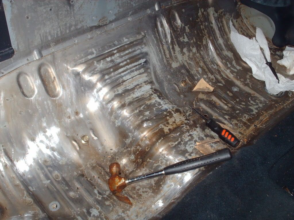

Body before (Under the rear seats)
After a 400$ color changing paint job

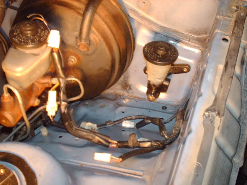

Clutch pedal installed:
Clutch Master installed:

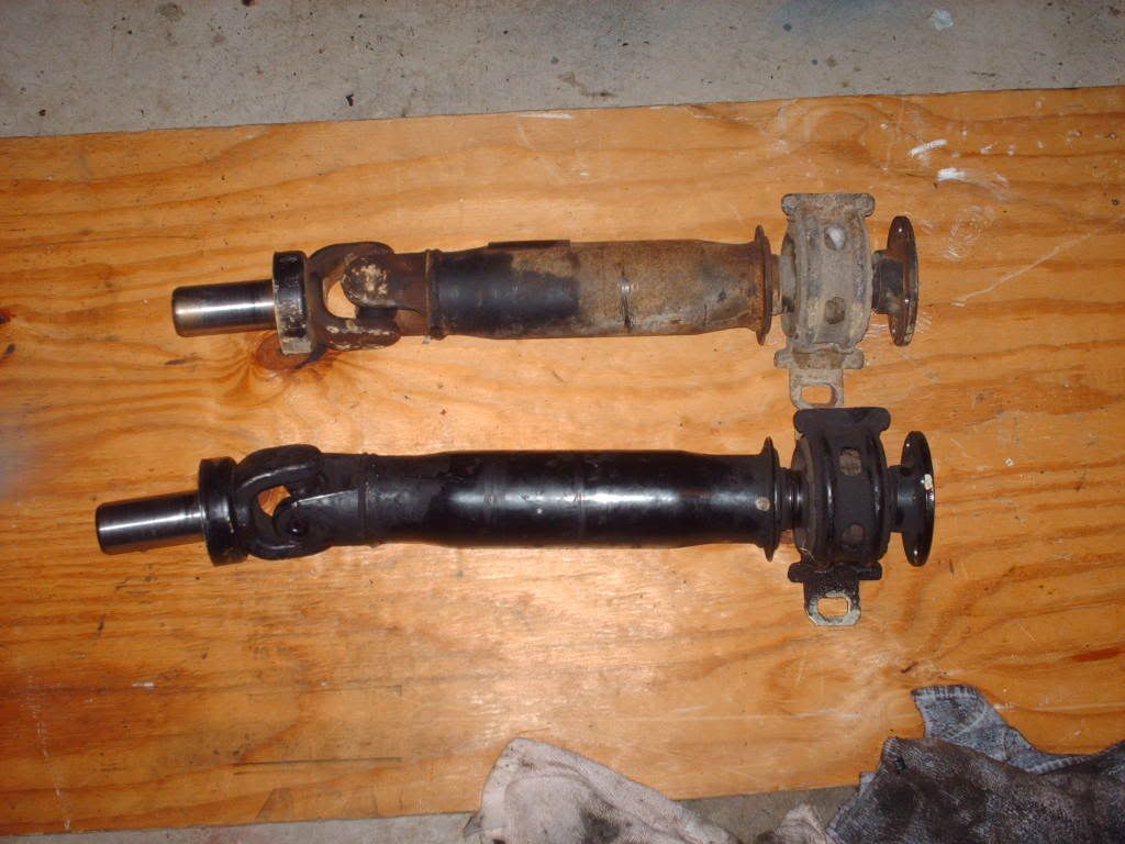

R154 Driveshaft (Installed)

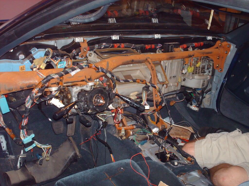

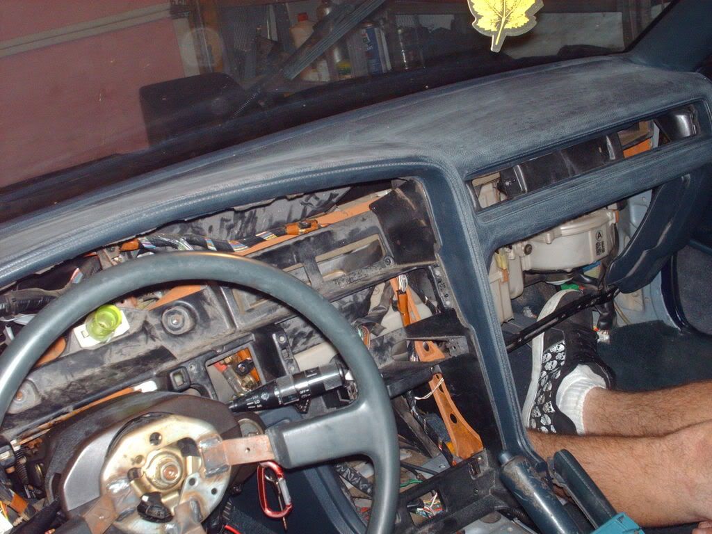

Dash looks good, but not good enough.
I want the same House of Kolors paint used under my rear seats (I removed the seats for good) for my dash

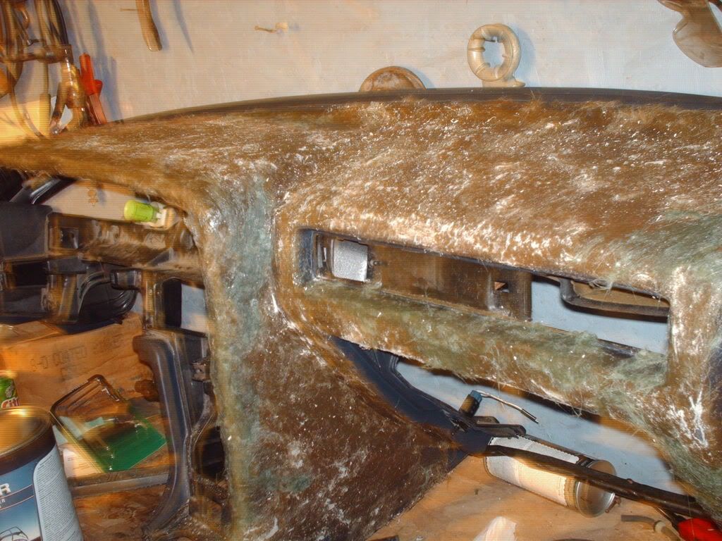

Fiberglass started
More to come

Fiberglassed dash is ready to paint (pics soon)

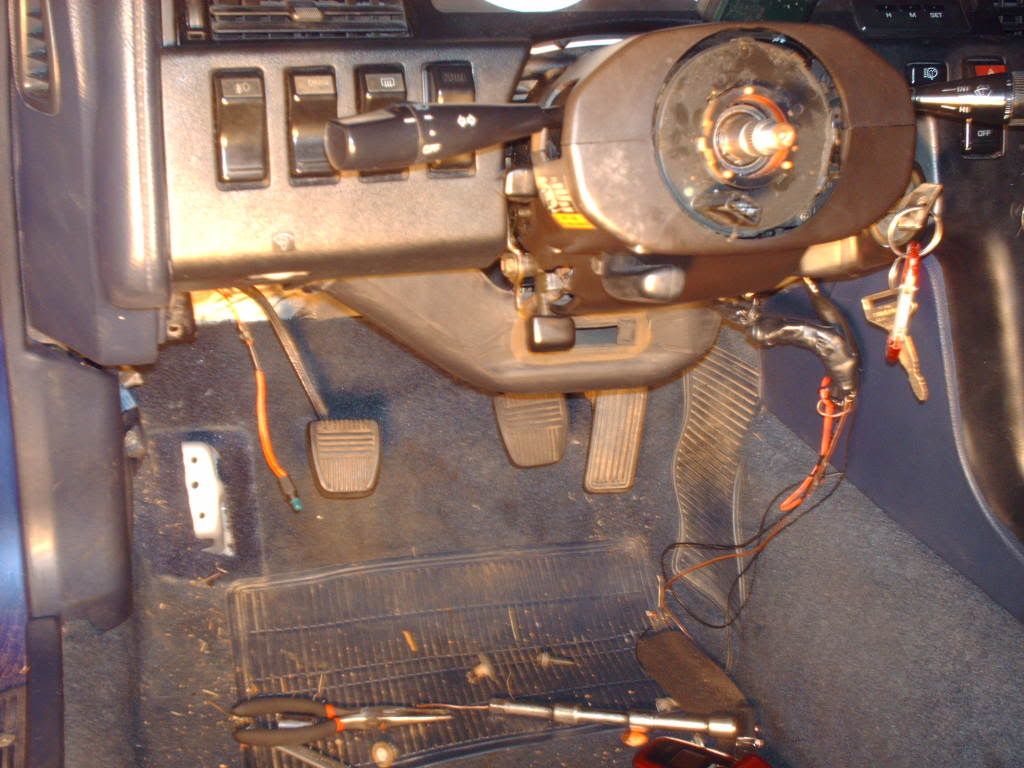

the more i look at it the more i think the brake pedal bracket got bent during shipping, id grab that sucker and give it a pull, straighten things out a bit.

highnitro12187;1109915 said:
looks good so far, but something doesnt look right in your pedals, the spacing is off it looks like. any exterior pics?
Yeah I didnt use the 5 speed brake pedal bracket and used the auto one so the clearance between the gas and brake are different
exterior pics soon to come! Interior is a mess right now
