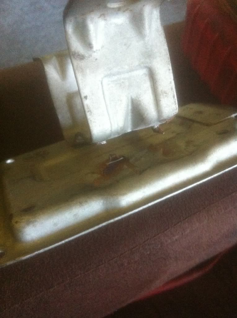

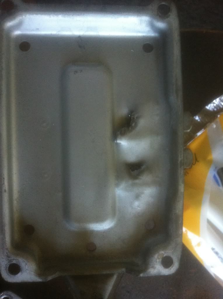

I thought i fixed the problem before. Anyways i have brand new coils. Although my first coil doesnt have spark and i have weak spark. i tried switching them around to see if the first one didnt work but it does. Next i decided to look at my CPS. I found out that two pins were switched around so i redid the wiring on it . But still no spark on first coil ! By the way as i went on i made sure everything was properly pinned on harness side to the ECU. So i got to my igniter and i found something strange
one side is completey off ! Thats why i might have weak spark . Not only that but the inside of the bottom case is lifted up and might be touching the c1 signal wire to my 1st coil grounding it out ?
so right now im doing the igniter ground mod and also flattening out the case and maybe put a strip of electrical tape inside the case as extra.

What do you mean you switched wires on the CPS? The PCM is looking for a specific signal, and they are not interchangable. Go ahead and ground it. But that also will not cause one of three coils to not fire. Fire weak, sure.
