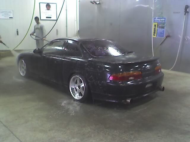

Heres a picture of the car
Here is a picture of what will be going onto it in a few days after the fenders get rolled. (wheel placed beside the vehicle )

nice ride and welcome to the forum.
I'm also from Regina and have a black jza70. My brother has a soarer just like yours. Maybe i'll see you around some time.
i have seen your supra around. Beautiful, it really is.
