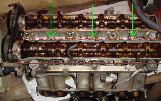

I replaced mine with oil drain washers from NAPA. The NAPA part # is 704-1076.
As stated earlier, you can remove the gasket completely; but the four bolts that hold the 3rd cover on do seal oil passages and need a gasket to seal back up after the 3rd cover has been removed. The three bolts at the bottom of the spark plug galley with arrows pointing to them seal the coolant passages, and should not be touched.
