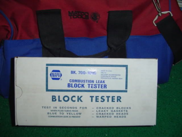

Frank Rizzo
Jul 25, 2007
478
Fixing your girl's car
I said block test, not compression. You are better off leak down testing rather than compression testing if you are going to remove the spark plugs. I've had a BHG or 2 go undetected by just a compression test alone.
Compression test does not = 100% BHG detectability.
Block test = 100% BHG detectability!!

run a coolant system cleaner, prestone cleaner kit. you usually want to with JDM 1jzs because they might have been sittign there for a while, run it and it'll clean all of that crap out and you should be good to go. when i got my 2jz i took off the thermostat and all i saw was brown sludge (do a search on the forum you might find the post i think either doward or jdub responded to on how to remedy it)
i wouldnt worry too much unless i see it in the oil hehe
there is also a BHG test kit isnt there? i heard they work to some degree... or they fail horribly.....
