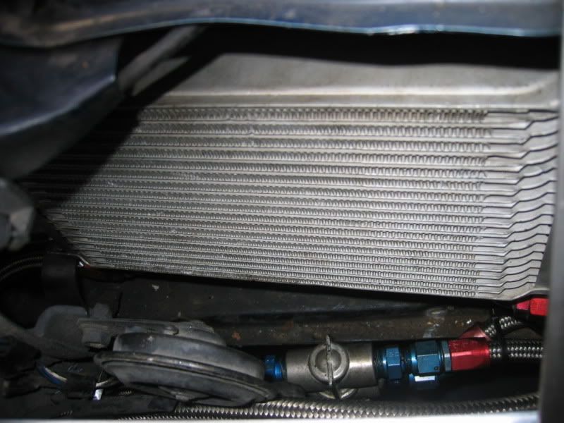

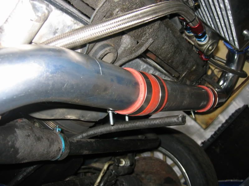

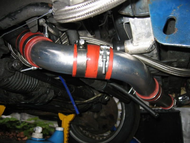

This might be a total newb question, but here it goes. I purchased an oil cooler/ relocation kit from a fellow SM member. I got it all installed, I just don't know what to do with the stock line (not the one that was coming from the block) Pics to help explain. I haven't traced the line back yet. Does it come from the oil pump itself? It's the black line hanging down under my intercooler pipe.
p.s. I just have the lines ty-wrapped ATM. I will be properly securing the system when I figure it out.

ya dont leave that open! There is a fitting on the pan that the line attaches to, remove it and plug it.
Before you start it, make everything is flowing in the correct direction...

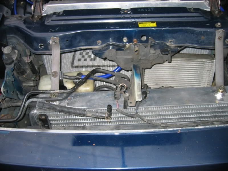

Where did you put the cooler at?

Perfect, thanks. I'm pretty sure I have everything in the correct direction. The cooler is mounted just behind and above my fmic. A/c has been deleted. I made 3 brackets for the oil cooler, you just can't see them in the picture.
I also moved the overflow tank.

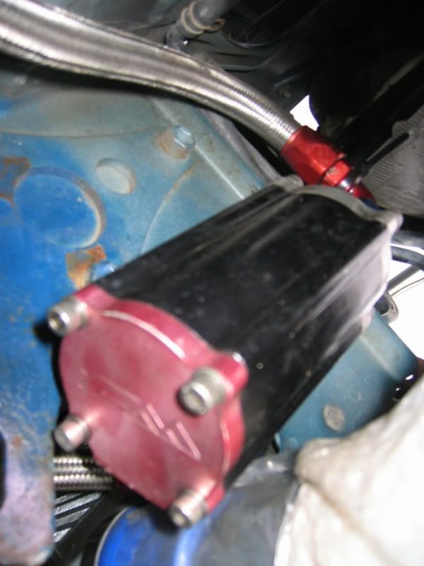

Here is one of the filter location. It's under the passenger headlight.
