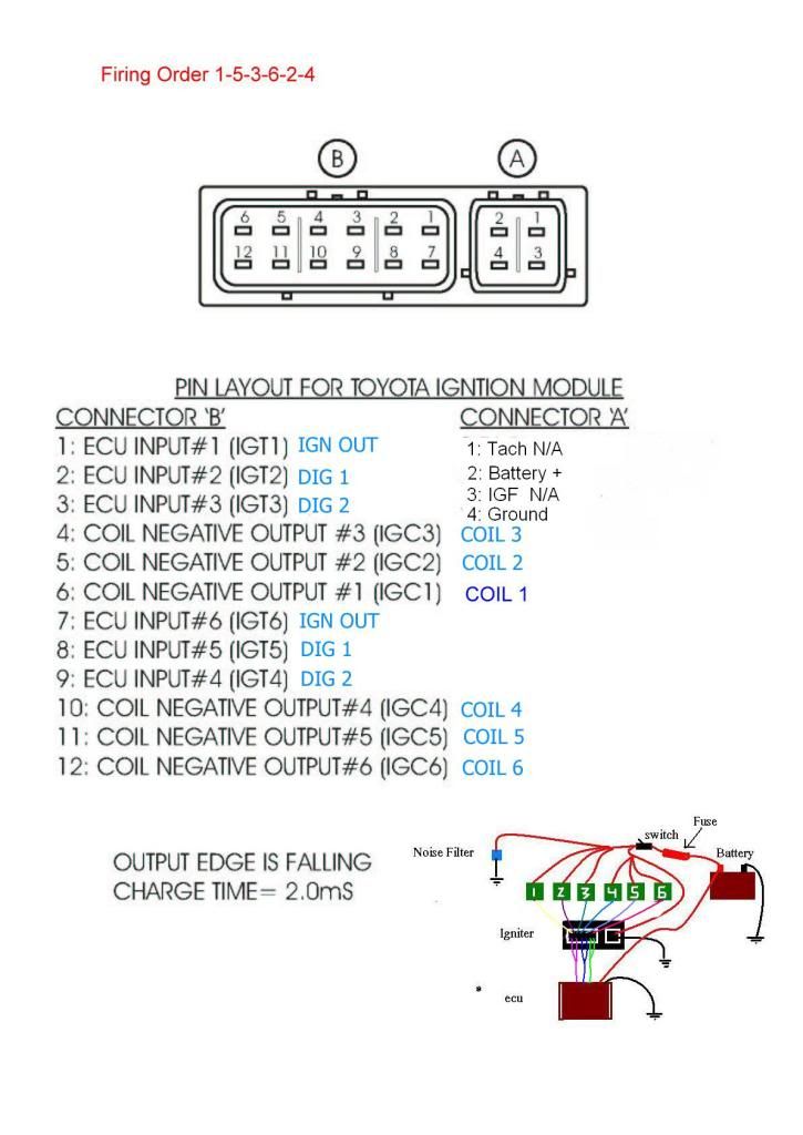

I suspected my igniter to be faulty but turned out good, figured I should post these results to see what you guys on the forum think.I found the online igniter pinout for the 1jz and and here's what I got:
pin 1 and 6 = 1878
pin 2 and 5 = 1888
pin 3 and 4 = 1897
pin 7 and 12 = 1877
pin 8 and 11 = 1905
pin 9 and 10 = 1896
Picture posted below of online pinout used, disreguard the ms-paint drawing
