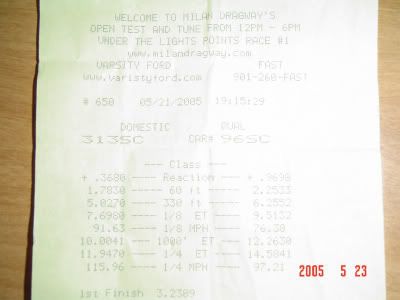

Do you mean into 14's or out of 14's. I ran a 13.8 with a 2.15 60' and 99.5mph, so there is no reason why you shouldn't be mid to low 14's as it is. Do you have a slip?
edit:
Here is a slip that is closer to your numbers. Even with your 60' you should have 14's easily unless you are having issues shifting or a slipping clutch?
