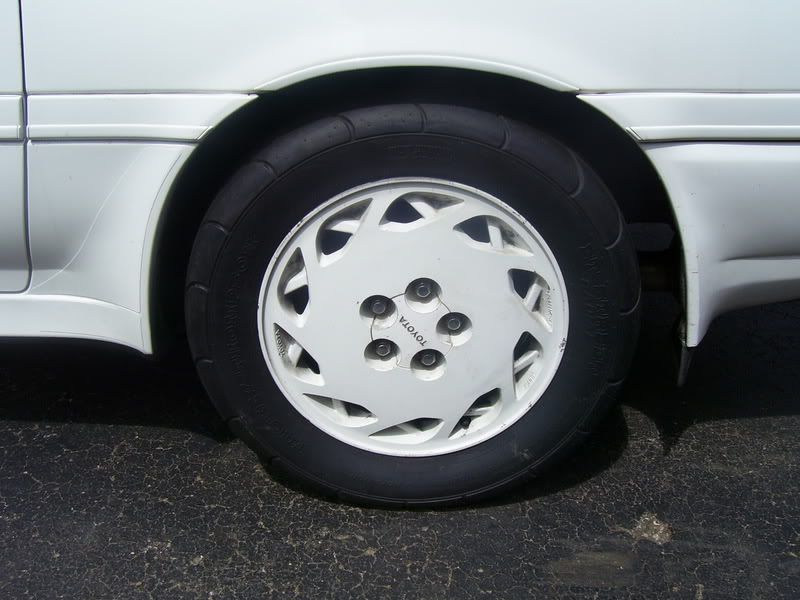

here is a pic of mine w/ 255/50 bfg drags on sawblades

Yeah but the Nitto 315's fit more like 295's. The BFG's are wider, I have had both on MK4TT wheels and they are too wide. Get a good 275 and you'll have better contact patch.
