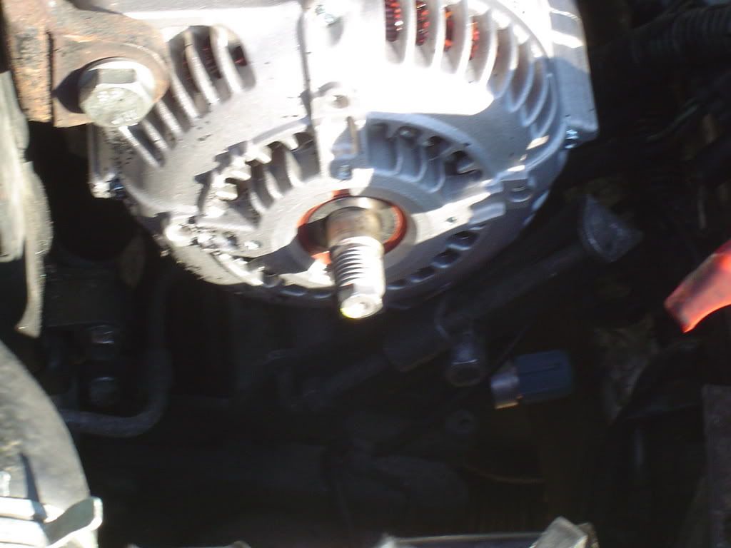

ok so i was running the car pretty hard at high rpm and the alternator belt slipped off, So i put it back on and it started squealing really loud and suddenly it just stopped so i got out and checked the belt, it got so hot it, ripped and it pulled the pulley off with it, the pulley bolt came loose i guess, and it seems like there's alot of play in the fan, like it wobbles...

Does the alternator spin freely?Unusal for the pulley to come off by it's self.

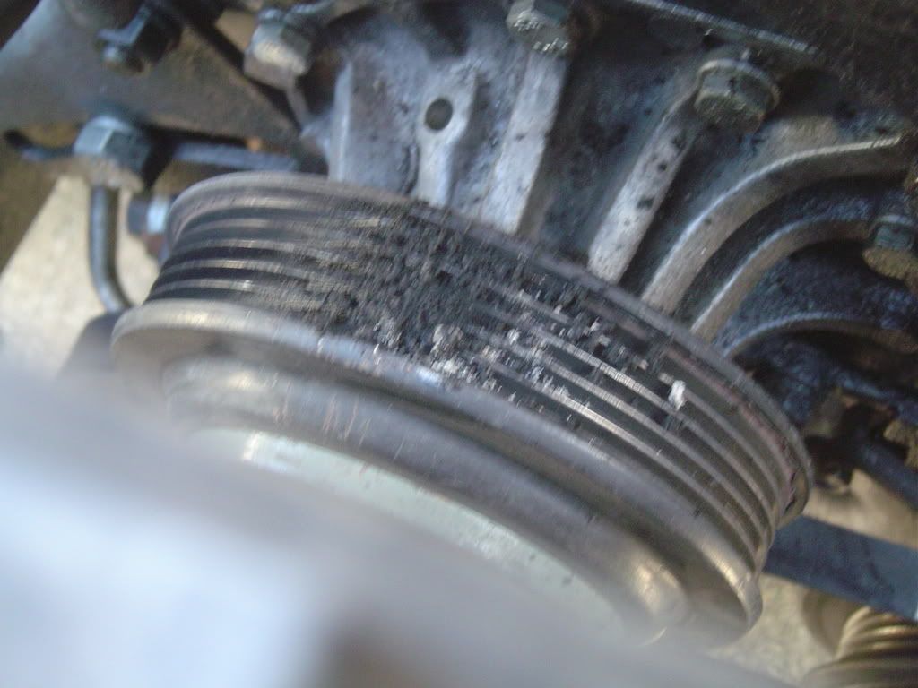

What caused the WP pulley to stop spinning? In your pic I can see burnt belt material that tells me the pulley stopped spinning and burned the belt. The alternator pulley may not have been properly tightened and came off. This is just a theory however. I have no answer on the PS problem unless that belt is damaged.

if the burning belt is on the waterpump then its more than likely the waterpump locked up and burned the belt till it snapped.

I'd take the alternator back to O'Rielly's and pitch a fit that they're POS alternator came apart and ripped the belt, and they should replace both. Looks like maybe the nut wasn't torqued properly on the alternator. Also, reach in there(with the car off), and spin the water pump pulley. It should spin easy. Try to wobble it up and down as well. If it wobbles, the w.p. is bad. If it doesn't spin easily, the w.p. is bad.

There is no way the pulley would have come off if they had tightened it correctly when it was remanufactured, I also vote for going back to the parts place for a replacement alternator and some money back too!
