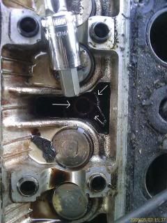

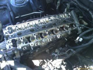

I stripped 1 of the 14 headbolts.. they are stock head bolts with the 10mm allen key socket..not sure what to do...trying to change my hg and pretty much stuck here...
The allen hole on the head bolt is stripped.. what to do to get it out?? thanks

What do you guys think of an apoxy?? like jb weld?? you think it'll harden enough for me to get a grip on it? open to suggestions and comments lol...This one head bolt kept me from removing the head and getting it re-surfaced...on thursday...

Had a Torx screw strip on my Harley. here's what I did: Take a cold chisel, angel it so that the strike of the blow on the chisel will force the screw head in a counter clockwise direction. Tap until it free spins and unscrew it. Buy new headbolts. Recommend you get good after market ones.
