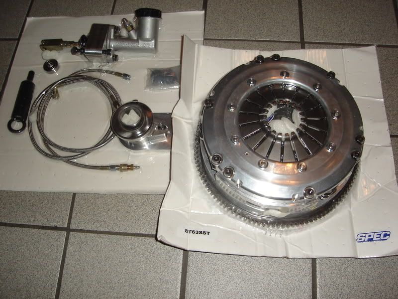

The one spec uses is from Wilwood. It's listed on the Wilwood site and can be bought from jegs, summit, etc. It comes in several bore sizes. The bolt holes are vertical and you will need an adaptor to make it bolt into the supra, use the spec pic as a guide.

i have the spec master(wildwood) and it over extend's the release bearing.i'm not a fan of having the low pedal and would rather have it a little higher
here's a pic.you can see the addapter attached to it.
