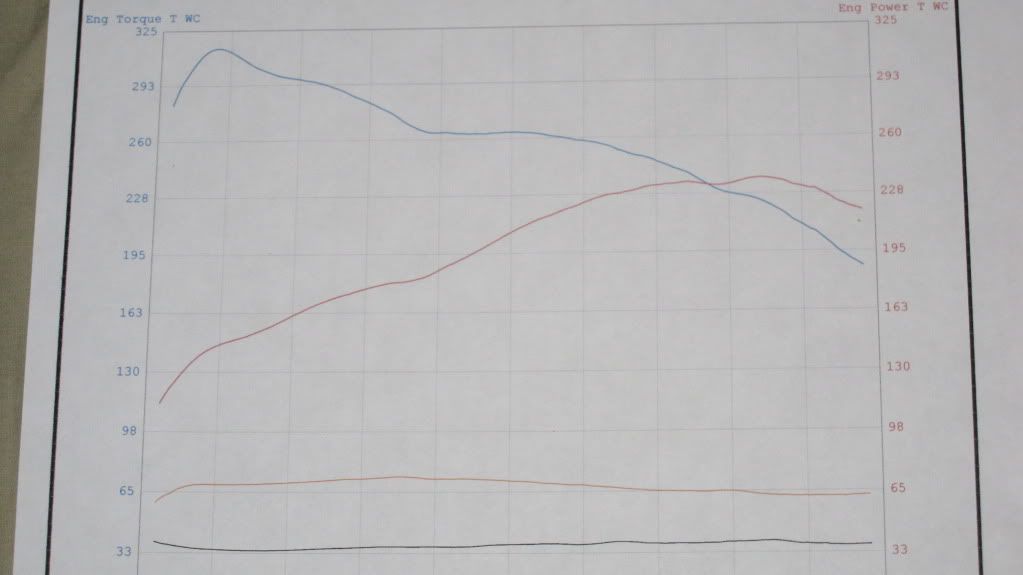

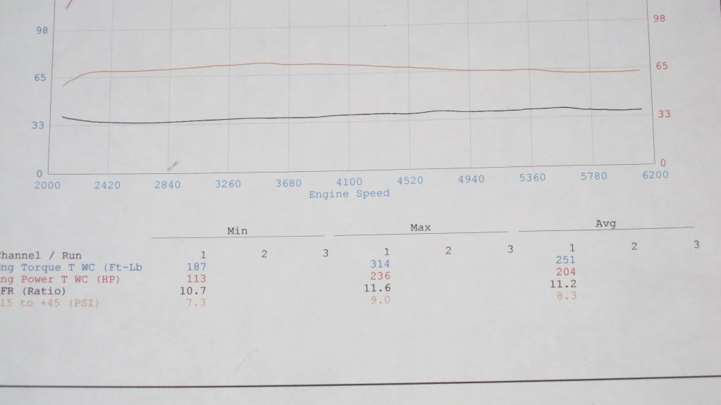

Just got back from the dyno this time a mustang dyno and here are the results.. However I didn't have the torque converter locked so don't know if that played a role in it or not but going back tomorrow to do more testing...
Here are the graphs.. Does everything look okay as far as the HP and TQ? It seems like the TQ just drops off A lot in the top end compared to most

Are your cams wore down?
What exhaust and elbow?
Maybe the dyno operator messed up the correction values.
Was this in in 3-4th gear (3rd auto 4th 5 speed)?
I dont think its because the converter.
320tq at 2200 rpm
then
less then 220 at 5500?
Does not seem right.
How does the car pull does it fall off hard after 3000 rpm?

Car pulls hard period.. My cams are not worn down at all.. Think it may have been something with the dyno.. Going back later this week hopefully to re dyno it. I also retarded both intake and exhaust cams 1 tooth which equates to 15 degree's.. I felt it just by driving top end power picked up some.. We'll see how it goes. Its stock elbow and down-pipe but the catalytic converter was cut out.. It was in 3rd gear

Maybe mess around with it like retard only exhaust to get more overlap.(Might not help with a boosted car)
If its pulling hard to redline then the graph is off.
Stock DP could be why your psi is dropping.
It should still have a flatter curve i would think.
