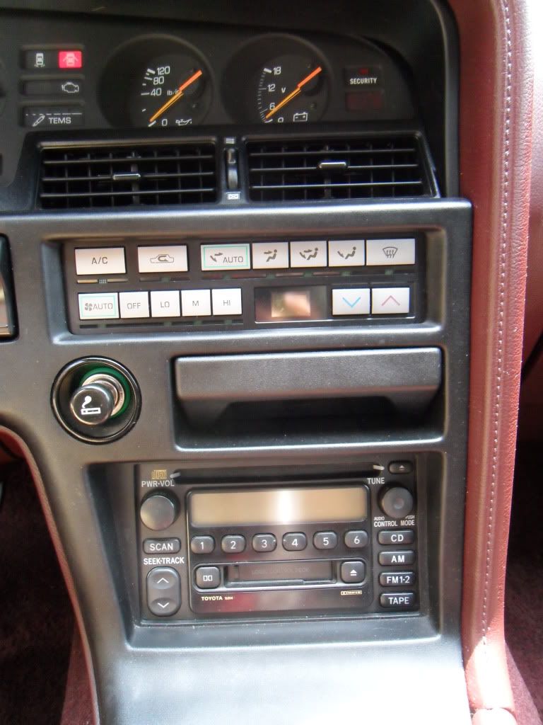

When I replaced my origial stereo I put in a Toyota 16814 stereo that I got off of ebay. It fit perfectly without any modifications, its lights are green, and it looks 100% stock.
Here is a pic of mine:
