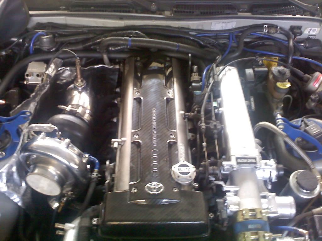

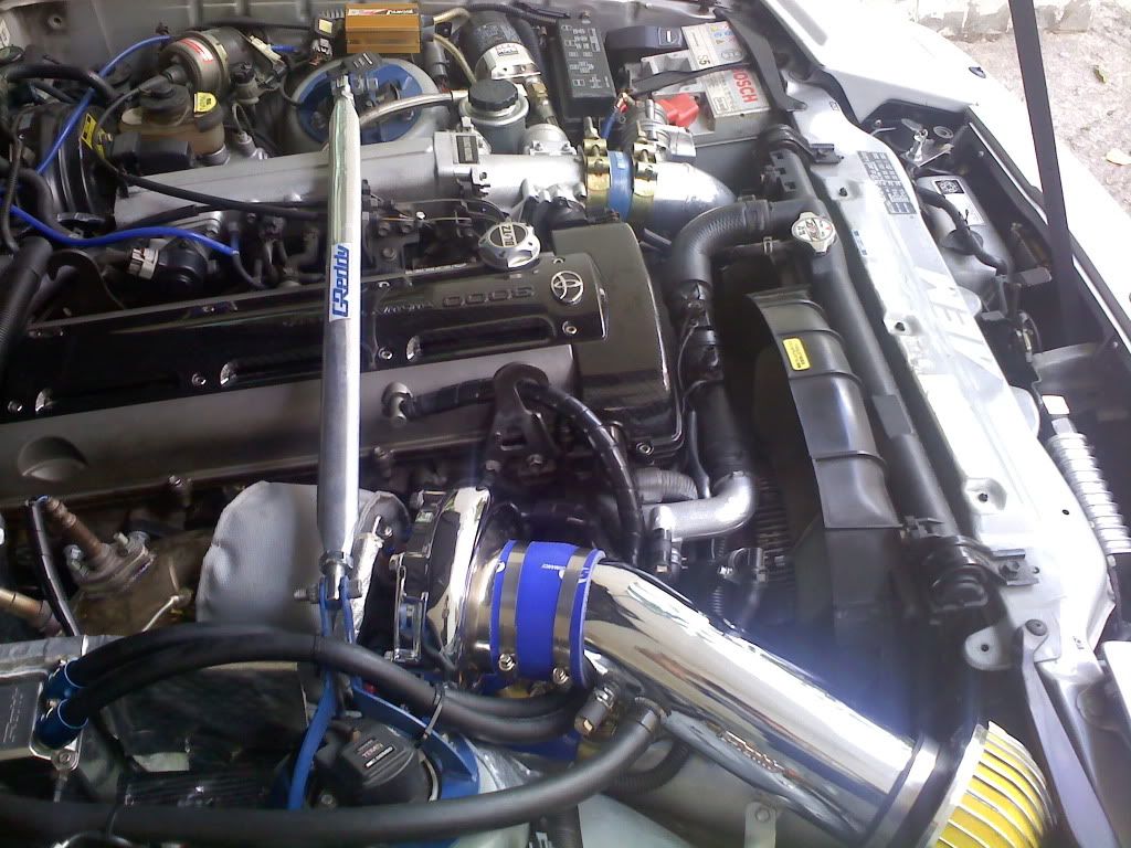

My mk3 is 2jz single 72mm (0.70 A/R twin scroll) , 7500 rev limiter on AEM, 264 HKS cams, 4'full exhaust system,tuned
on 95 octane pump gas,and boosting 21 psi (1.4 bar) at the moment. No dyno sheet available at the moment...

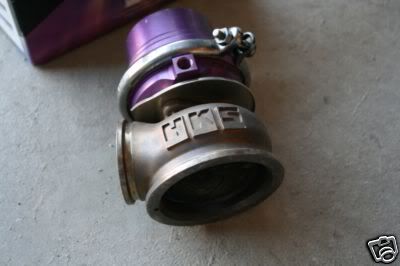

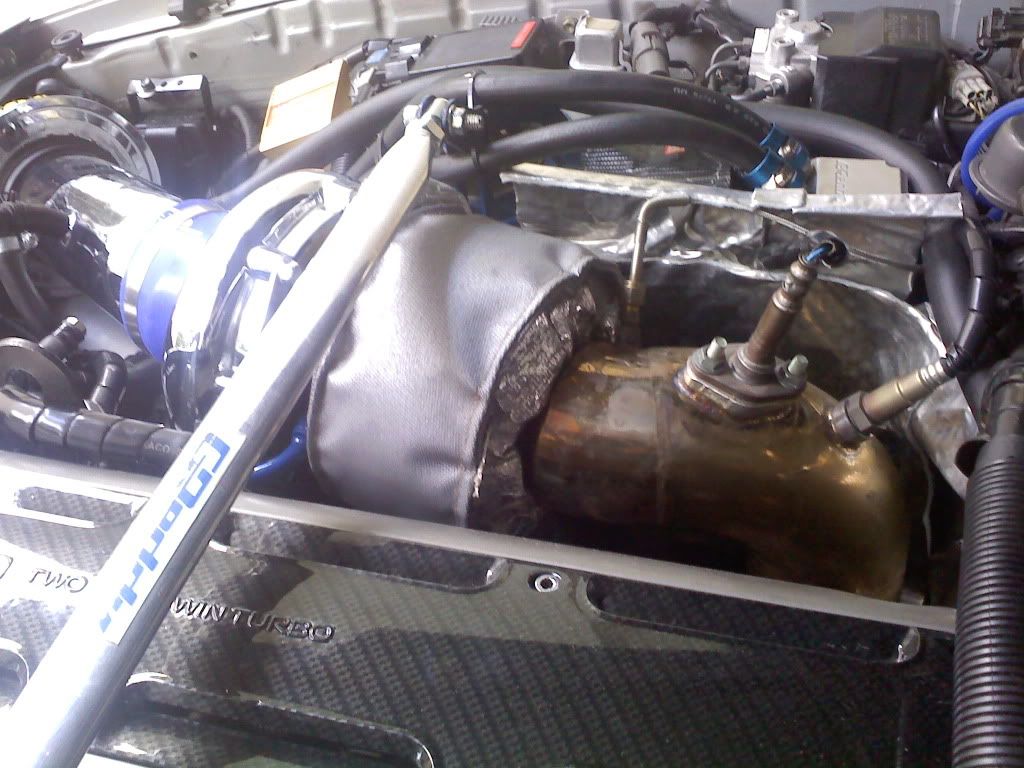

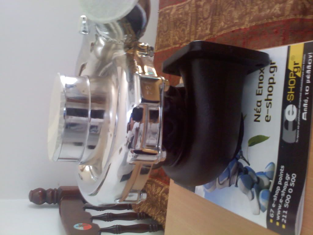

Many guys pm'ed and asked me about my exhaust setup:

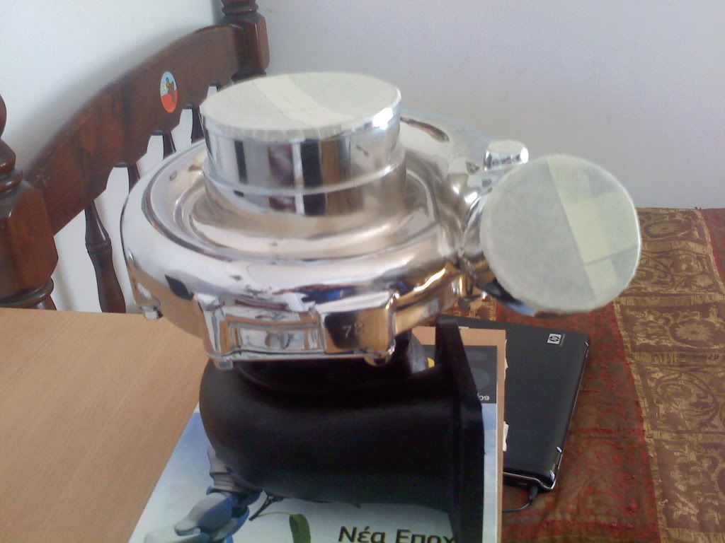

Turbo is a T4 ITS 72mm Q'trim, Twin scroll, DBB, oil/water cooled, with 0.70 A/R turbo housing and a 3'' V-band back.

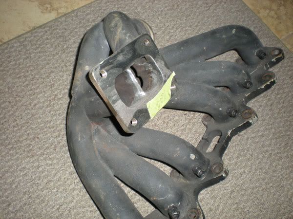

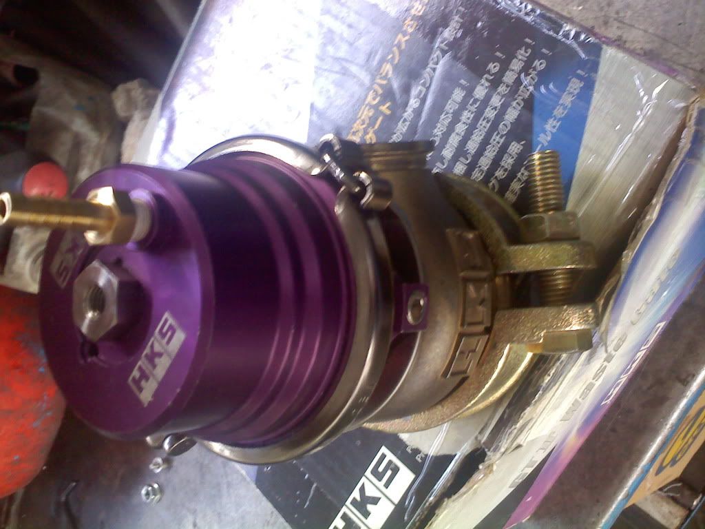

I got an HKS GT T4 Exhaust manifold (ceramic coated) for a 60mm wastegate V-band flange.

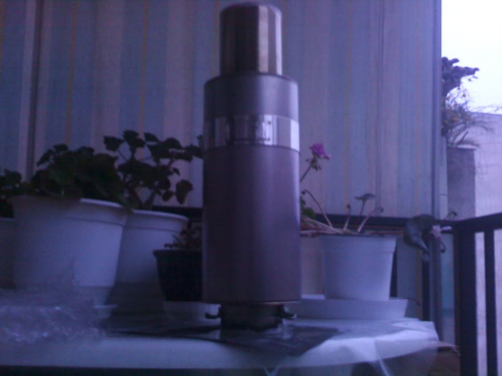

The wastegate is an HKS GTII 60mm with an HKS 48mm screamer (ceramic coated) pipe.

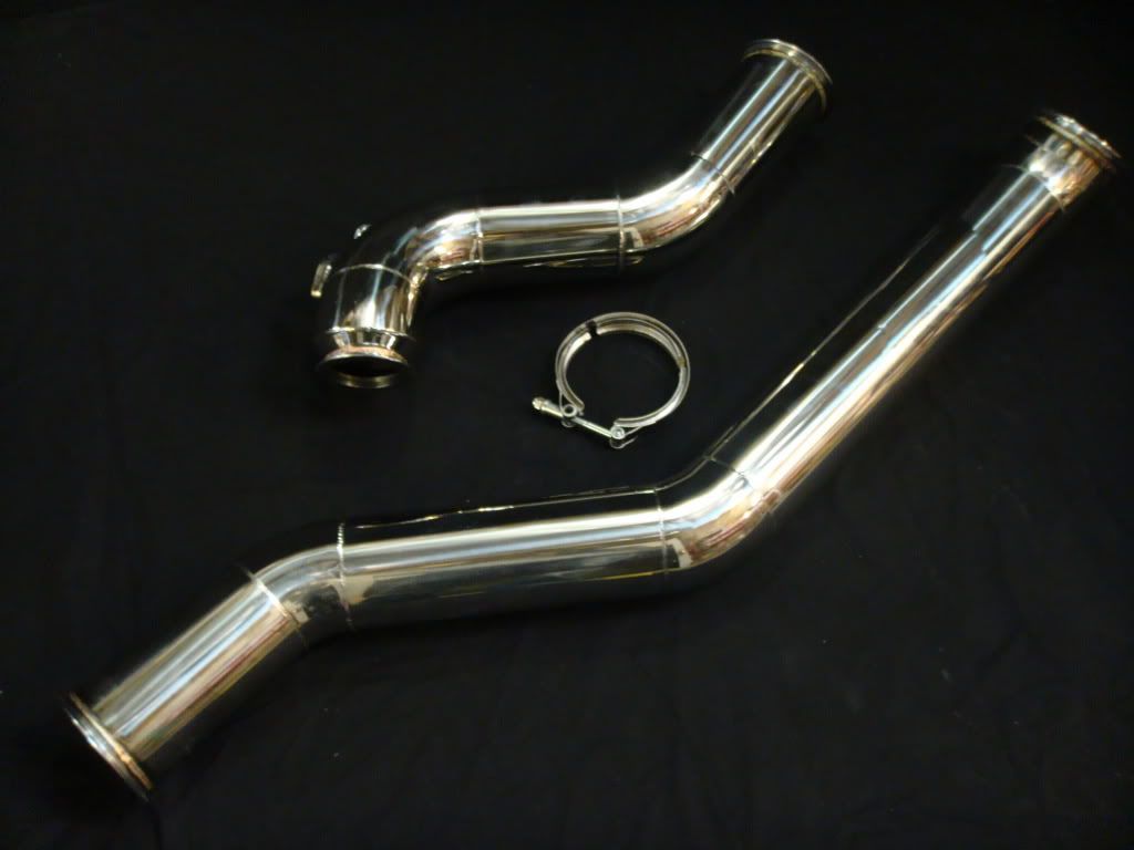

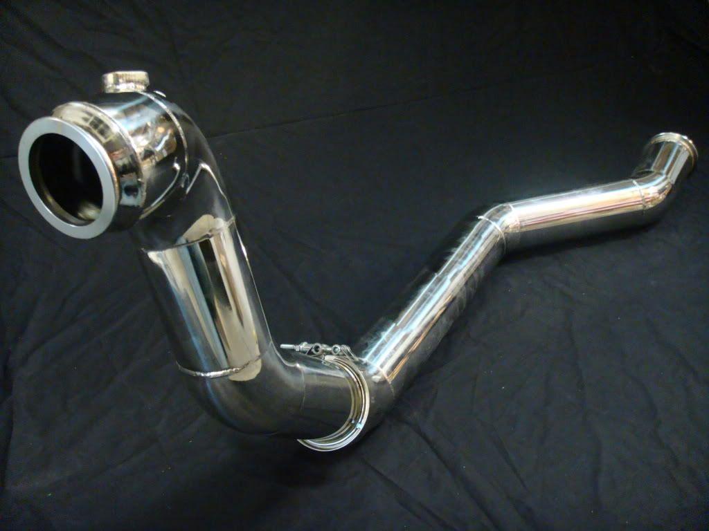

Ebay 4'' Downpipe-midpipe with 3'' V-band for my 3'' turbo housing V-band and a 4'' V-band
for the mid pipe which ends to a 4" V-band cat-back choise. Great quality,price,and very light
dp - mp system from ebay. I think the guy's still selling this...and the pipping is polished !

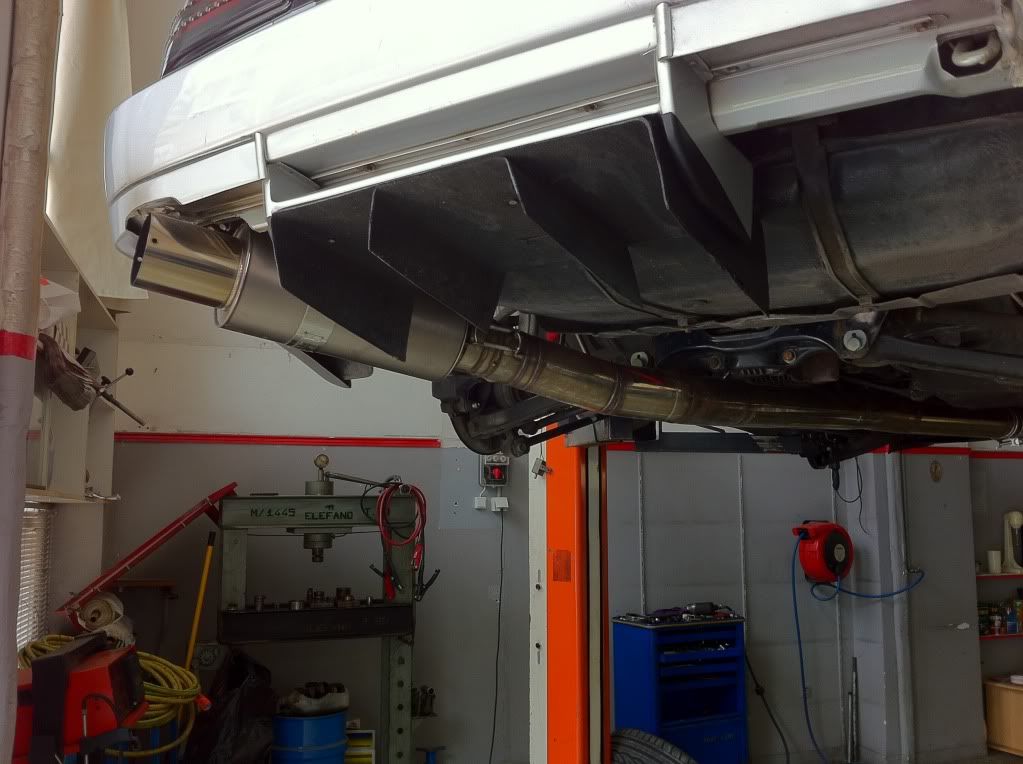

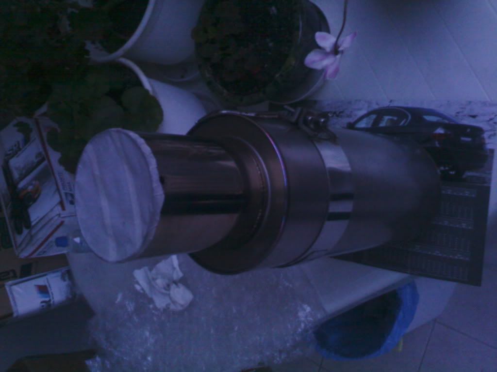

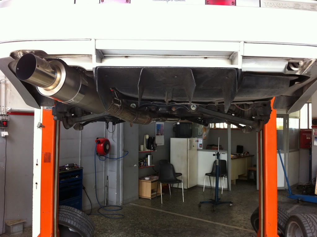

Installed..
HKS Titanium racing 4" cat-back (for mk4 Supra), but was modded a little bit to fit under the mk3 Supra.

CarlosPTR210;1791713 said:
Nice supra, could you post more pics of the rear air difusion? i want to build one :D daaaammmmm nice!
Sorry...don't have any more pics of the rear diffuser. It's custom made from fiberglass.
