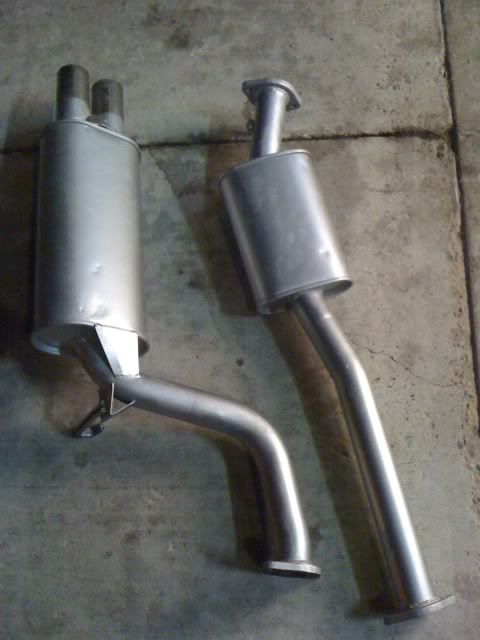

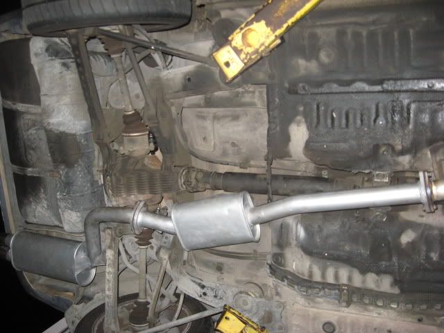

Nice thread you got going here! I allways admire a good 7M-GE build. I have the same HKS exhaust, got it with my 86.5, I had a test pipe on it as well, and yea, it was very quiet but sounded great. I have the same intensions as you with it, it is looking scratched and a little beat up so I'm in the process of sanding it down and laying a few coats of paint on it, I'm thinking about hanging it on my wall when its done. :)
