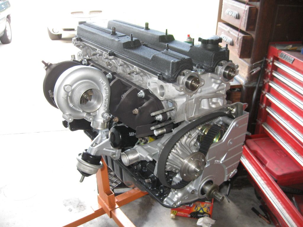

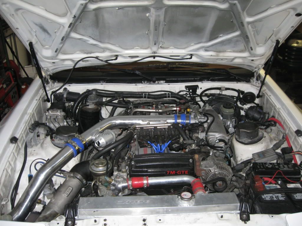

Well the day has finally come, I kinda been side tracked over the last month because I'm finally buying a house for me and the family so that has been top priority lately but the 7M is back where she belongs, all fluids filled, gone over the checklist about a thousand times in my head. I finally turn the key and nothing, the starter must have bad brushes and got worse sitting on the shelf, I put new copper contacts and plunger while it was out . Hit the key a few more times and starter turns and engine fired right up. Purring like a kitten, solid oil pressure, get it to temp, nothing leaking, out for a drive. Running very strong, feels fantastic, even got a semi when I heard the turbo spin again (been DD a NA for too long). I'm stoked, got a little stinkies from all the new paint and such getting to temp the first time but other than that things are great. :bigthumb:

As requested: Cold start, well as cold as it can get in FL in July. The stock 440's are snapping away but the motor is purring. After break in my 560's and new fuel should be going in and I'll get another vid then.
Sorry don't know how to embed the video right here, but here's a link

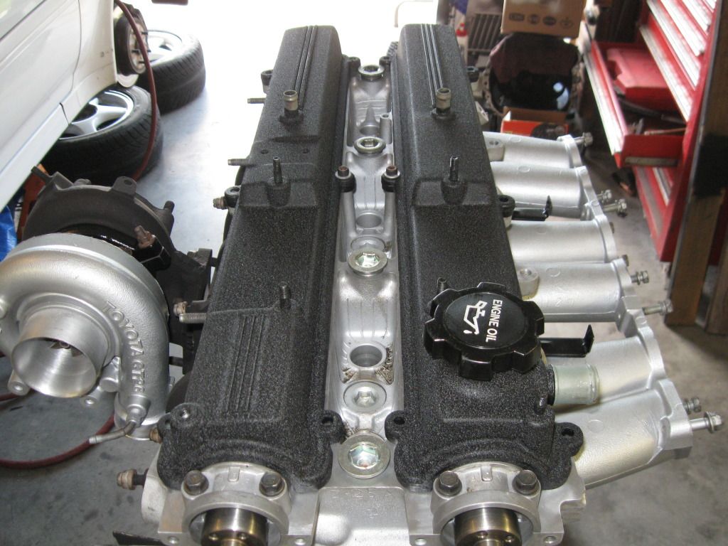

I gotta say, I love the wrinkle finish on the timing cover. I was planning on wrinkling the valve covers and intake manifold, but now I think I'll include your example.

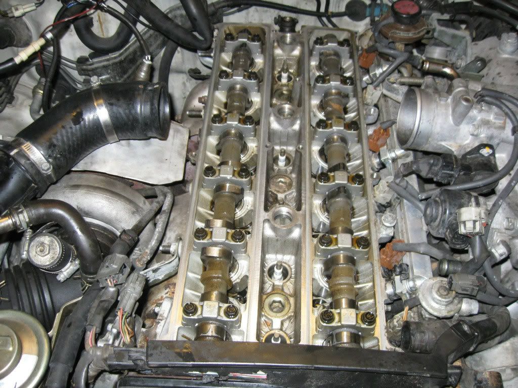

Its been awhile since I updated this so here we go:
BC264 Cams went in and shes running great.
