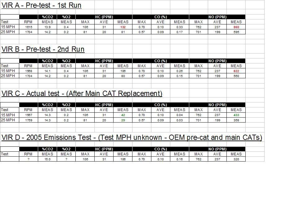

Just as my build was being completed, I was already due for my Smog Check. The last time I have been directed to a Test-only station. This year I was not (I barely passed the last time). Still within the engine break-in period, I decided to get a pre-test done ($40), just in case I failed horribly, it would not be transmitted to the DMV. I took the advice of several posts on this forum regarding warming up the CAT before the test.
See the image below for details of the Smog Check Vehicle Inspection Report:
VIR A - My first pre-test run. Obviously failed.
VIR B - My second pre-test run. Better, but still failed. The smog tech warmed the car up a little more on the dyno before making another attempt.
At this point the tech recommended a new CAT.
VIR C - My first run with the new CAT. PASS! (this was the actual test for the certificate).
VIR D - I dug this up from archives and added it just for the sake of comparison. I cannot find the initial change of ownership smog check
data.

- I was very surprised that my brand new hi-flow cat did not help me pass emissions, but then again there were some comments made on some old
forum posts that may have indicated the possibility of some hi-flow CATS not being helpful in passing smog.
- The tech did not know the brand of the replacement 3" Main CAT or whether it was a hi-flow type. I took a look at it and I could not identify any markings, but this CAT was about 30% longer then the OEM Main CAT and 40% longer then the Carsound Hi-flow I had already
installed.
