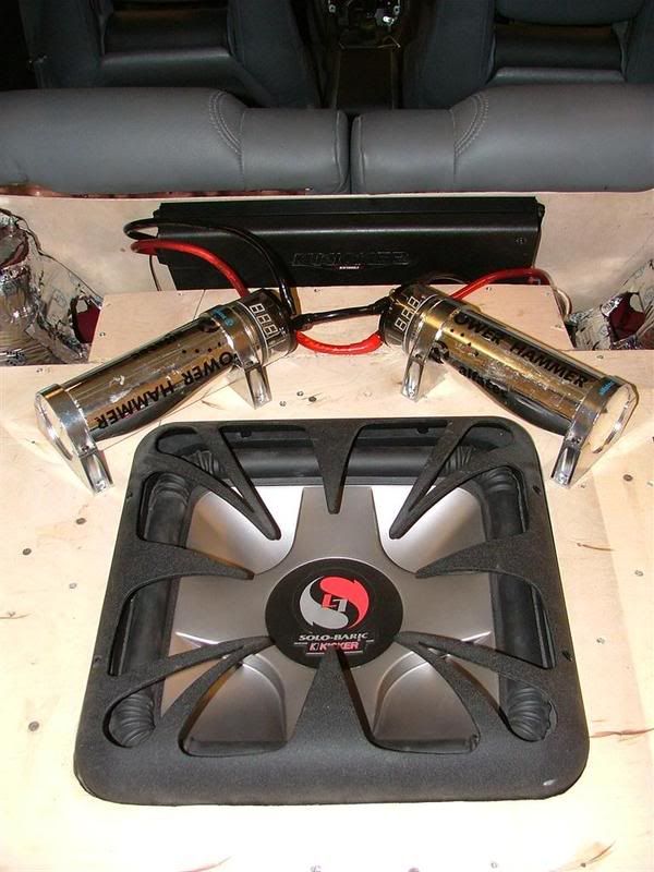

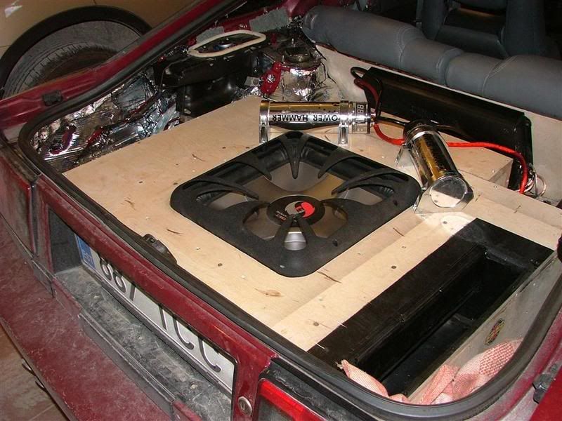

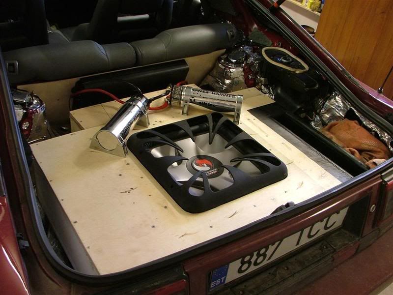

pbasil1;1069228 said:
Ya . Just the right size by the looks of it?
So thats a 15" L7... If i were to guess ^ cu/ft... And hopefully tuned around 25-33hz? Unless your tying for spl... Then a good 40-55hz should blow the supra to bits! Am i close?
That's what I was thinking, by the area of that port, it's in the 40s, unless the port's wrapped around, taking up like half the box.
BTW, my tests have found the Supra has a resonant frequency of 44-45hz, if anyone is curious.

If you want to do a quick test, run some tones, and see if it gets noticably louder at a certain point. If it doesn't, it's likely flat enough to enjoy.
However, with the area of that port, I have a feeling it's tuned quite high.
