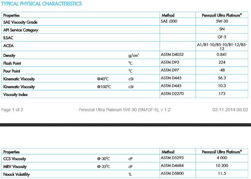

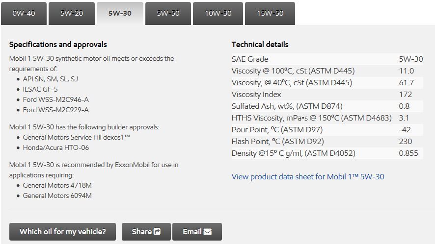

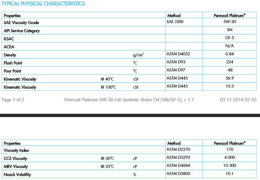

Comparing the specs of Mobil1, Platinum and Ultra, IT looks like the penzoils have a better cold viscosity for my application then the Mobil. My oil pressure on a cold start is up around 100 on a 80-90 degree day. So i could stand to use a little less when cold. The hot Viscosity is just about the same. Its only off by about a half a point.
Im going to look into the Penzoils and see. The Mobil1 is just so readily available and cheap. I know its not the best option though.
