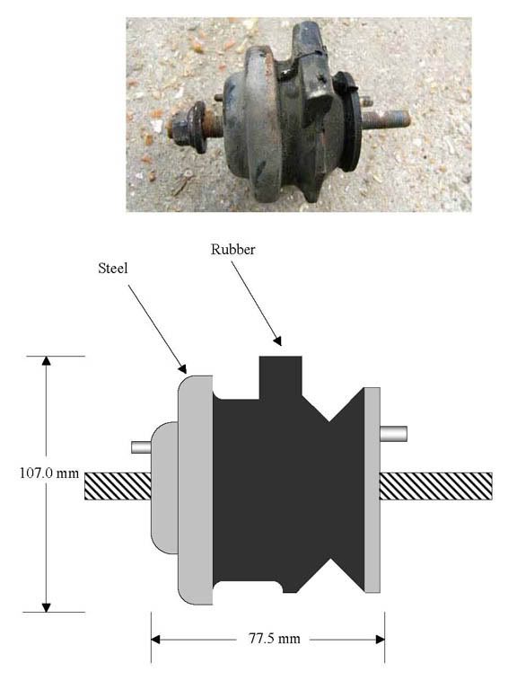

This may help, I ripped one of mine removing the engine some years ago and at the time I didn’t know about the 98TT So I had this brilliant idea of getting some fabricated by a company who recoats rubber industrial conveyer rollers (Hence the drawing) I eventually found some decent ones at the local scrap yard and dropped the fabrication idea, just as well as I didn’t realise they had a small amount of fluid inside which would have been a problem.
