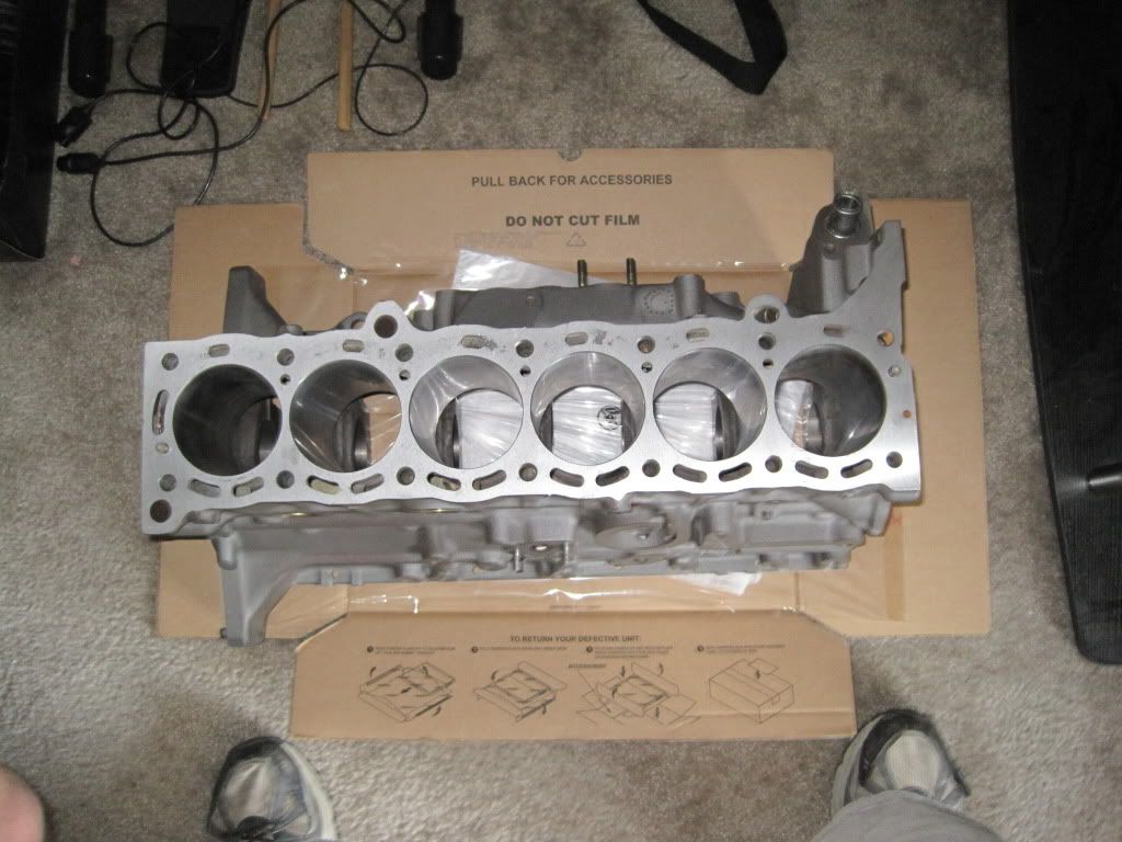

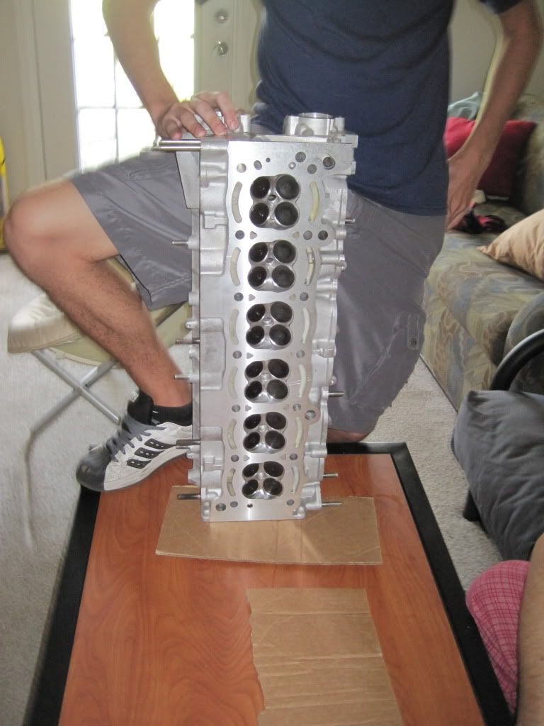

Something like this?

It looks smooth from the pics but it also looks like you have some pitting. As long as it perfectly flat with no ridges that you can feel with your fingers you should be god.
