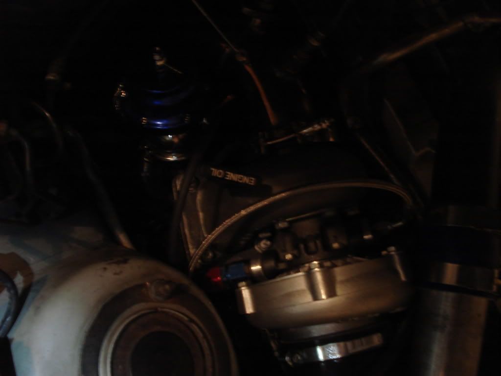

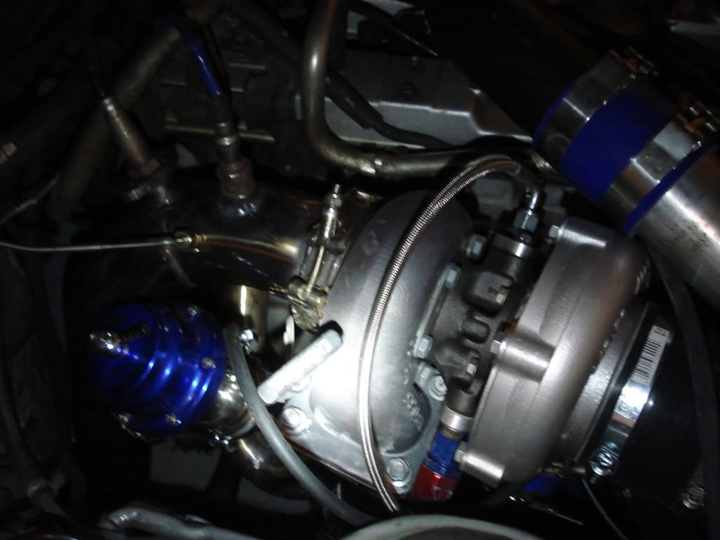

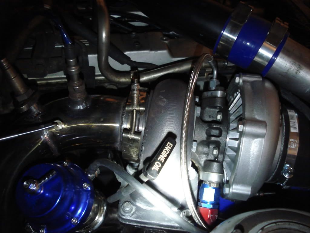

Do I have the Turbo Clocked enough for the Drain to be efficient? I'm using -10 drain & -4 feed. The drain fitting hits the turbo & mani mounting flange so that as far as I can clock it as is. If I need to clock it more I will rework the drain fitting using a 45 deg AN.
