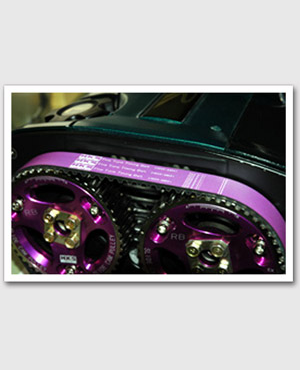

Has anyone found a good paint match to that of "HKS purple"......been looking for a while, can't seem to find anything......and the 2j valve covers are screaming at me for it......
EXAMPLE:
....please post pictures, thanks in advance
-Kris Blazer

it's not paint it's anodizeing....considering the valve covers are aluminum the also can be anodized....start calling "metal finishing/coating" places and see if they have a deep purple anodizeing...you can even go to a local machine shop and they can point you in the right direction to metal finishers...anodizeing isn't cheap...your looking at around $200-300 as most places have a base price...the more parts you get anodized the cheaper it is! You could have a custom paint mixed but you are still looking at $400 worth of paint that may not last under heat of an engine!

figured you only wanted the valve covers done...which I would recomend anodizeing as it's fucking sexy....but you probably won't find a paint to match unless you can use a hobby paint from a hobby shop that sells rc cars...don't know what kind of paint it is but they always have radical colors such as purples...it would also require a clear coat as that type paint is a flat finish cause it's meant to paint the "inside" of clear plastic car shells....clear coat will make it shine...
That or contact house of colors for example and send them a pic of the purple you want replicated and they can mix you up some at the cost of your first born!.....the issue is that you need a high temp-chemical resistant paint such as motor paint and I don't think places like house of colors deals with that stuff....rc car paint is tuff as hell and is resistant to alot of chemicals but it's meant for clear plastic and to be painted inside out instead of like most things the paint is on the outside.
Hell go to home depot and have them mix you up some rustolium LOL.

damn this slipped my mind....go to www.kgcoatings.com. They sell a product called gun-kote....it's was designed for firearms...the stff is cheap, tuff as all hell, very chemical resistant and can take extream temps....it bonds to metal and plastic....most of the finished are satin-flat though...but they have a bunch of other products but gun-kote came to mind cause I know they have a purple...I'd call them directly...think it's like $30 a quart
