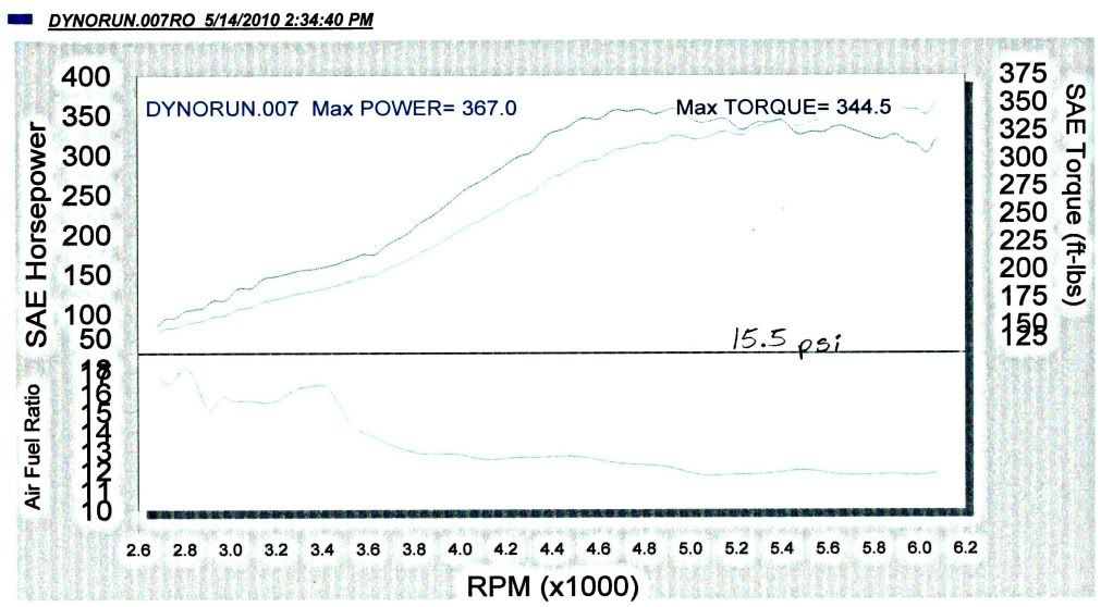

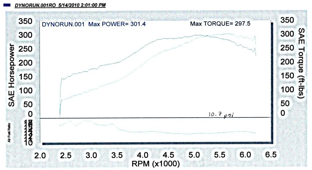

On my last dyno session, I gained 5 hp and 5 tq by increasing fp 5 psi. Prior to the adjustment, fp was set per the TSRM. Even with the increase, my power curves showed signs of a problem. They were wavey and dipped a bit.
The results of raising the fp left me scratching my head a bit. I have a built fuel system and certainly don't have a shortage of fuel. I plan on playing with fp a little bit more and gapping my plugs down to ~25 thou and see what that results.
Here's my dyno sheets for reference. You can see where power starts to suffer at the higher boost level.

Yes, and just as you described. In the lower dyno sheet that I posted, I felt and heard that dip in power. It has happened everytime I tried to exceed ~15.5 psi.

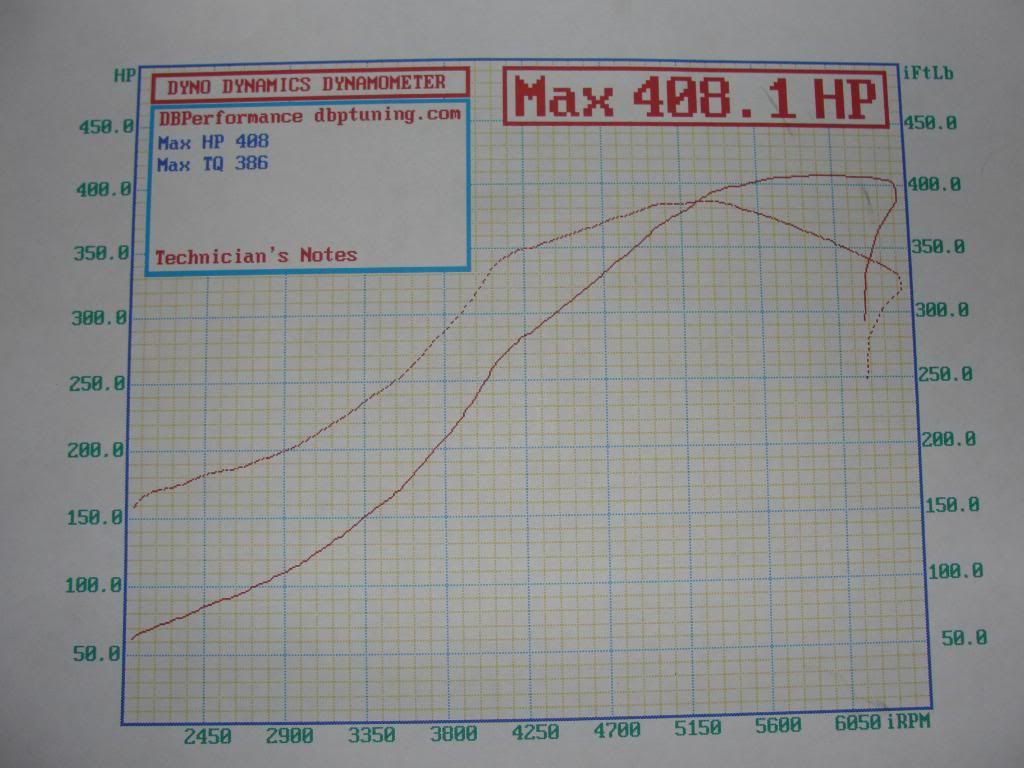

Alright Ken- here's my graph. Pulled very cleanly and didn't break up, using .028
The hump you see at ~4000 is the wastegate opening up. I have my ebc set to begin opening the gate at 15.5 psi, and that's what you see there.

^Good job! I saw that you did that on 92 pump gas at 17 psi. That's REALLY nice! That's the highest octane we get here. Any chance of getting a shot of your afr's?

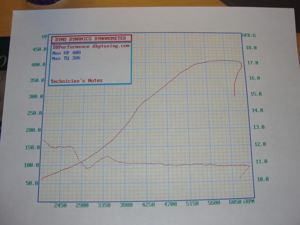

Ask and ye shall receive!
As you can see it's really rich, but I would rather build some safety into the tune. We actually made 425, but pulled timing in case I run into bad gas in the future. (too bad that doesn't count towards the HP list ;) )
I don't know if it's the igniter, or the coils, or both being together, but this ignition system is proving to be VERY robust! There's a local guy who's running an IS300 with a built 2JZ-GE with E-85 and the only time they ran into problems was when they were around 34psi on an 80mm turbo!

Thanks! Your afr's are nice and steady. What were your afr's at for the 425 pull?
I'm really glad you posted that because our highest octane here is 92 and I've been quite reserved to push the boost with that. My plan was to stop at 17psi just as you did. How many degrees of timing are being pulled and where?
You're definitely not experiencing break up like some of us are. Regarding your COP's, did you modify them in any way to ensure that they're reaching far enough down into the head for proper plug connection? I think that's why mine weren't working...

They went up into the 11.4 area at peak power, but I don't know how much timing he pulled. I know I could have made it work with that, but I'm fairly picky when it comes to my engine so I had him back off on fuel and timing for safety/reliability. If you followed my build, you'll see that I had the engine out to replace some bearings because I wasn't happy with the oil pressure (3 days before the dyno!).
