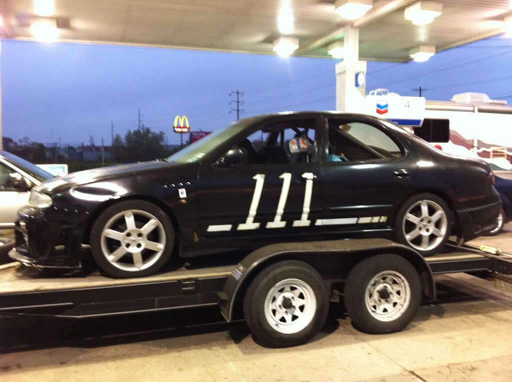

Hey man, I have some lowering springs just sitting in the basement. I hooked up one of our other Lemon's racers with some shocks dirt cheap. $75 for the whole set. Let me know if you are interested. hks88supra@yahoo.com since I am rarely on here anymore.
lemons is awesome. Check out my lemons car!
