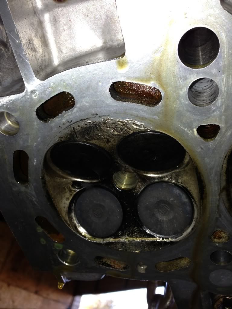

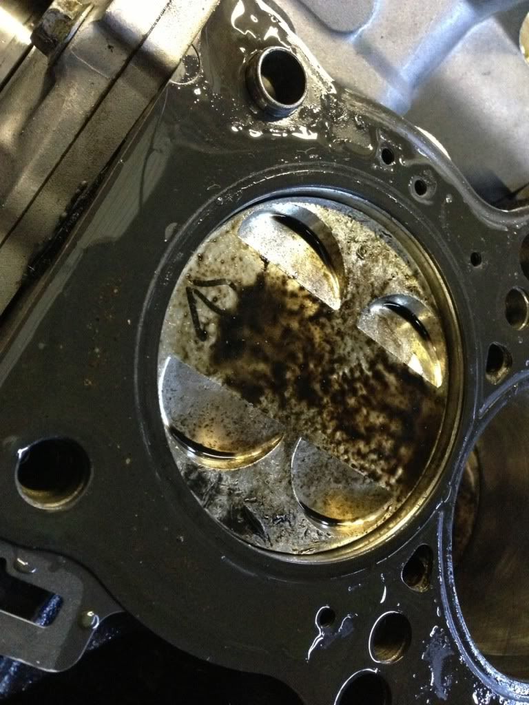

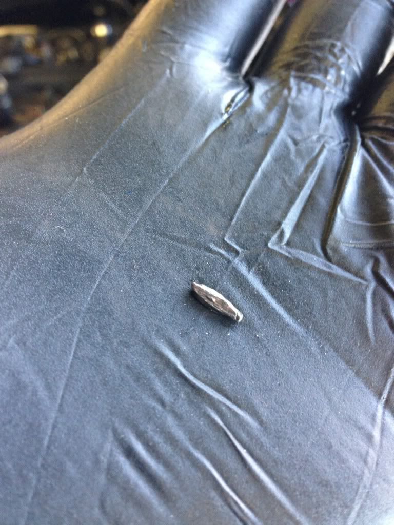

How do you know it's a rod bearing ?
To me to doesn't seem like the power you'd be making would cause a bearing to flatten out or go bad. First you should do is drain the oil and search thru it looking for metal shavings.
If its intermittent I'd be thinking along the lines of what just happened to me.
I have a brand new 1jz engine that has never been driven but was knocking very loudly but only sometimes.. Sounded just like rod knock. But it turned out to be a small metal sliver on top of my number one cylinder.
The noise would stop when the sliver would fall into the valve relief.
Here's a pick of the sliver and damage it caused. Believe it or not the below pics are a zero mileage motor.

Oh man that looks bad!
Yes I will drain the oil and take a look.
However, I can't see how anything could get into the engine as all clamps are on, filters in place etc etc.
Why I think it's a bearing? Because it really sounds like a bearing gone bad, and when I disconnect the nr.4 spark plug cable the knocking stops immediately.
So as soon as there's no power in that cilinder the knocking stops. If there was a rock or metal chip inside the cilinder, I guess the noise would not stop after pulling the spark plug, or would it?
It would be great if it wasn't the bearing that 's gone bad! But if it looks like a duck and quacks like a duck... :'(
