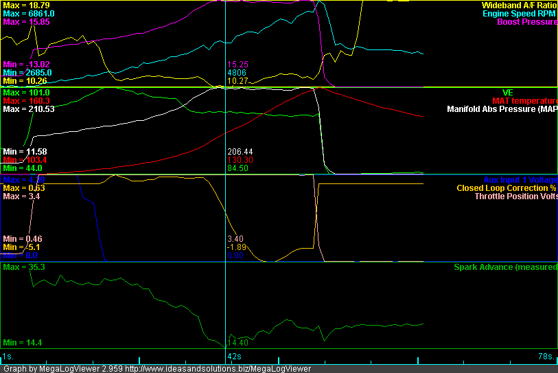

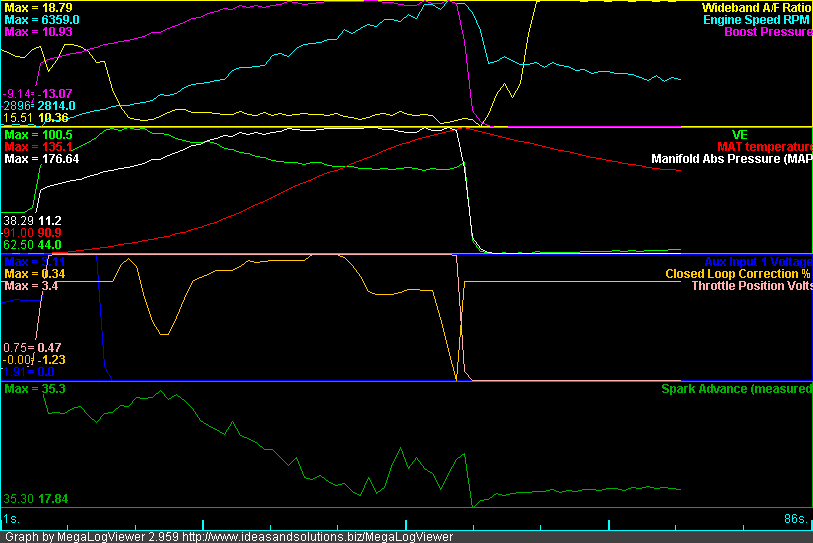

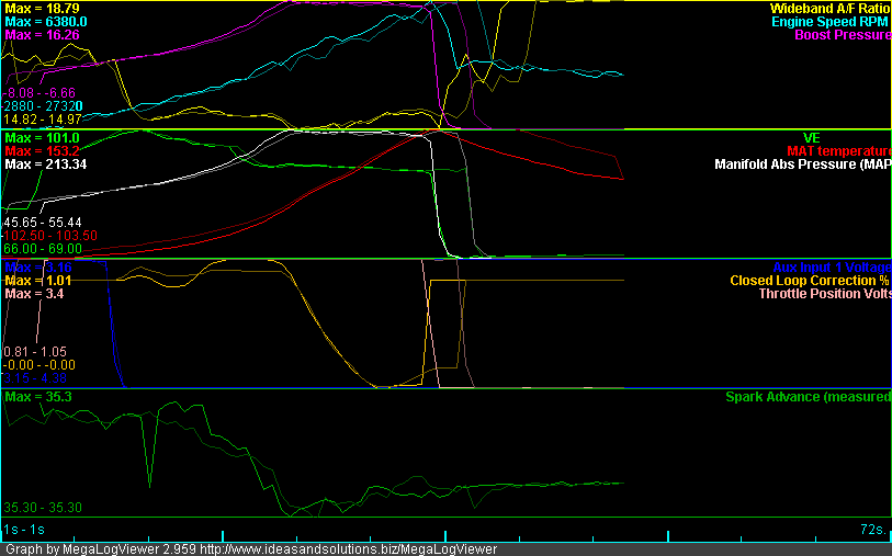

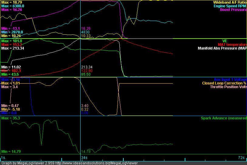

Below are four logs and here's a brief overview...
Log #1 is at 12psi.
Log #2 is at 16psi
Log #3 is at 16psi
Log #4 is Logs 2&3 overlayed
What I'm concerned about is what happens at rpm ~4800. At 16 psi there is a dip in AFR's and timing. This doesn't happen at 12 psi so is the ECU pulling timing at higher boost due to knock?
I have no codes.
12 PSI
16 PSI (back to back logs)
Two 16 PSI logs Overlaid
